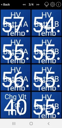

It did work as you suggested, but the dashboard values were all too large. I went into individual entries on the first three dashboards and corrected everything. Here is an example of how dashboard #3 looked before I modified it:
That's very odd.
Were they large like this after the initial 'restore' from the .cbz, or only after you imported the cell voltages?
In general, I used 100 as the text size for the numbers, and 48 for the titles on each dashboard entry (unless the title was too long, then I reduced it).
I wonder if my sizes only worked because I was using a tablet... Maybe they need to be smaller to fit properly on a phone.

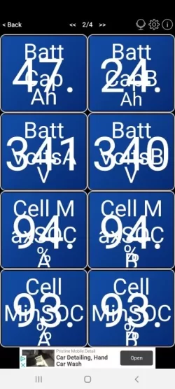

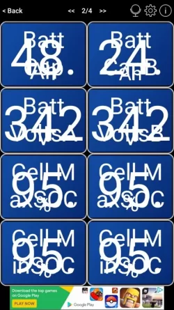

First off, thanks a bunch for getting this whole setup and process figured out with a few others in the forum.
Yes, I have the same issue with the fonts (pic attached) on my Android phone. I think we need to adjust it down
for folks using phones. Minor issue really compared to the work you have put in. Thanks again !!
Here is my actual data (already updated the google doc)
Build - 7/18
Bought - 9/18 (Within a week of car arriving at the lot)
Model - Base
Mileage - 21888 miles
EV driving - 90%
Battery Capacity - 47.44 Ah (quite low compared to others)

Clearly the text settings are too large on the sample dashboards.
I'm sure this is probably because I set this up on a tablet.
Can someone suggest aesthetically pleasing sizes for a phone?
I will change them and re-send a backup file.
There are three size settings for each dashboard item (title, value and units).
I had them set to 48, 100, 48. Or, if the title was too long, I lowered it some.

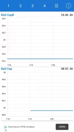

ok, just tested in Android 48.9.
bought in August 2019. 29k kms, maybe 25k in EV mode. battery pretty much fully charged on L2 and discharged 6 times a week.
Seems like it's excessively degrading, no?
we are in QC, so uses a.lot.for.heating in winter, but we dont have a lot.of.hot days that would be bad for.the battery
So the warranty kicks in at 30% loss, which is at 38.5? Mine is leased for 4 years, so I will see how it goes over the next couple of years and decide if it will kick the bucket before or after the warranty expires to see if I keep it or return it.
12% for 1.5 years seems a lot
Warranty is 2/3 (33.33% loss, or 36.6 Ah).
hmm, I thought it was more like 70%, not 66. We will see how it degrades over the next 2 years, as I don’t anticipate the usage pattern to change much.
Also, my car was a floor model and obviously they didn’t give me the capacity at delivery- the checklist they gave is probably the generic one they use for all cars. So it might have already been down as I doubt they maintained the battery at 40% when unused.
aren’t the other manufacturers at 70%?

They were large like that after the initial restore. Importing the cell voltages made no difference.
See my post above you. The higher % of EV driving equates to more charging cycles which I think is the #1 reason for
battery degradation.
