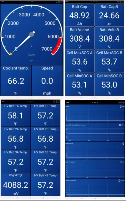

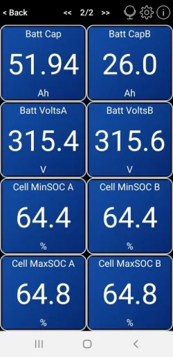

This is a nitpicky point, but I just noticed an oddity on the last item on Page 2 of the Dashboard. It is apparently intended to display "Cell MaxSOC B", and the data looks right, but the label is shown as "Cell MinSOC B".
dk9uQDJFkY5x0kNLFbKqMv40dQfxafpJCPl055GM4MX3Kp4BmynFC3-ECuQKUx3BbiQiOTjal5sl806bxa66b6PjxokVxmjs5Ox9jDoRmrZU7SCDIQdOR93sDYHcUgnVT1L_6UnD_ZUNEWPAapHdHsJf5Rr5aG8aABQt5OcA4O-qbALHWs3rku1DRiB7hYYUWqLTfl36jpJDTTSg9xYFCHov68MjDX5IPWcNTH6UiTfCuKV4Sr_q3ekv-q9qWzPTLlIeN3Af5Un7hKZVcOLaqtuNJjgkDXOue6sD-Z4Hb4QQGaGBfUrJuJjEGzN0iwBrsvX8dIH5455HhTnMwRIswF_Tqi50k2JEceV-V6-R78eUEhk8ezTD0I5gAhCWrsk6cxZSp-BNIo31mncNdyOsKwWEVUihnR3Q-F-V7ifLVavelqXKHWe6eufTmU_fkUv04Zph5ZsMI2vkwJvVTzfG6kopToFQaf2tABSxG3K6Q8XXnz5OhjNflGBaIxh6wV5OniJAQiqUbli3KjoLQull1HW_ugUmwW5cYeebuTEtrHxNLHE9xwT5jgR-LhHo1onhQjE3bK0Tj4C3TguSCN-Kuhy00y8WKkpsMYOAmdCBsV6N26cLOrLYcIlbbNSjZaTGPr-1q9NLrzeCHbQq7lnaAjTFuuET_tLdfJTLWstJ6nnc6V4dnKFWz51B-I4HTaRQOUS-1Q0JYFyp3JnSi1D0Eci2pw=w418-h903-no
The Item editor indicates it is targeting the correct Sensor, but that also displays the wrong title, and I don't see a way to correct it.
mOsSZfw_K6I95TovqZBQqDtLtjoAEdqZTRHbiBhtTFSyC_kq4_jOKlW6PzCnfxh-HIL31kiilIV6Yxhfv8yOt6CY8cbR96NS61QrKyhcQNXYOyRjUkIYQHunz0G5MgySRvbBUdYVVf5tuyyjg0AVY8ppQMghgTB_loOEc0hq8Q3VhfxRMU8aGhZtMARws5tLHQSI3OdU-YtTO-LsF20Ph4h51yrG-WQK9WYJZAMoUED0epzMHZ2RRwXilt69pVoxLiX3RO_AFIn18rs_HCD95W1-mvy1IcptX23wle-PjGfr-mk2kNEHivMigauDMPNUvBFV7OZ4SlS7Lib39mUMOpkkr-h-oZzK5sQ6XJk1UDpTwS05YwLGseR_q88u6YTgwTl67NFEqt8V2si6V85AvGRh-sDvfPayiubPq_Xdq3YsXQBi8UGvBpN-ZsnXlTLlHapNZUyGB13fkkCowDtb7wA74LMPh1Y4ZHaEsH4_RaHHMk8Mlv8F1B6m_b2TMEW8AwKom4qDnD-dkIqeYrdWOQoWlBSB3zcNBxH2EmBN5B98QDZMFYczT8n8grtLEx-neiyXrpyjI9oM2jgCjE_wE4uXJFmryJs9PRPgcss1R7XP0S7Kn9TJdmlihxzXs3ixsw5k2fqs6NGSHugvLAzwsViw-FEH0eE5PfAJMs84hxTOiSnNp80hTTZVxcGs9hZqyliErYocApluI6-H5YQ3AseGag=w418-h903-no
You are right !
There is a "Long Name" and a "Short Name" associated with each parameter. I have a typo on the Short Name with that one...
But, now that you mention it, it seems like the Min and Max are also reversed for both (ie: the 'min' value should always be less than the 'max' value, right?)... Let me look at that. I will get them sorted out when we release the next set.
Thanks

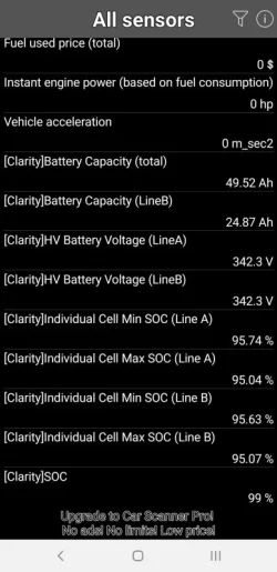

25,000 miles, honda clarity 2018, used the
Vgate-LPHUS iCar Pro Wi-Fi OBD2 Scanner
with car scanner app
49.5
49.5

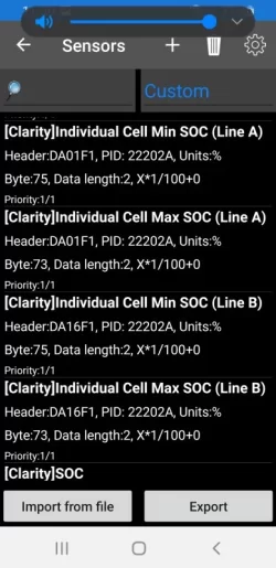

The Cell MinSOC and MaxSOC are reversed. The byte in Min should be 75 and Max should be 73:
Also, I changed the Dashboard Batt Cap to 0.00, Batt VoltsB to 0.0 and Cell MinSOC B to 0.0
