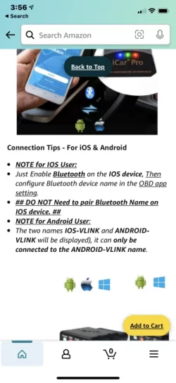

PS: to others who read the quick guide, if iPhone, you can use WiFi, select the WiFi network the device creates called VLINK, then the rest is same. There's a couple of models of this unit; one that does both Bluetooth and WiFi and a slightly cheaper variant that appears to be WiFi only (and labeled as such). I did the wifi only unit, but mine does not show up in Bluetooth. I have to select the wifi network VLINK or no gotty.
I tried using WiFi after the iCar Pro didn’t show up as a discoverable Bluetooth device in Settings on my iPhone. I got an alert about iOS 14.7.1 needing permission under Privacy settings, but that seemed to be on. What finally seemed to work was going back to Bluetooth but initiating the connection from the app, even though it didn’t show connected on my iPhone. I think. I predict I’ll have to grope my way through it again next time I try it.
I edited my original post, because I think its useful to know there are (or may be) different versions of this unit. There's one (like you seem to have) that has both bluetooth and wifi, and there's one that is wifi only. They're correctly, listed in Amazon, but if you do the wifi only model, then you may have to connect to the VLINK "peer to peer" wifi network that creates. I have no VLINK or similar in bluetooth to choose, because I bought the wifi only model...
I never saw vlink as an available Bluetooth connection on my iPhone. The only place it showed up was in the connection settings within the Car Scanner app itself (settings and then connections). By default the WiFi option is selected. Change that to Bluetooth and the device becomes discoverable.

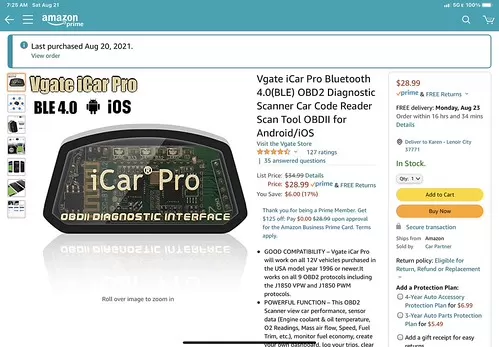

I want to make an important point here
Forgive me if I say something dumb about iPhone because it is not within my wheelhouse...
There are actually 3 different Vgate iCar models. They are designated "BT3.0", "BLE4.0", and "WiFi".
  • The BT3.0 is regular old Bluetooth and is intended for Android use
  • The BLE4.0 is a superset that runs both BT3.0, and BLE4.0. It works with both Android or iPhone. I think the iPhone uses the BLE mode, and an Android will use the BT3.0 mode.
  • The WiFi device is just that... WiFi can work with either phone style, BUT as someone mentioned, this is a peer-to-peer setup so you have to disable your WiFi internet connection on your phone while using this version of the device.
You have to be careful and be aware of which one you are ordering. They are NOT the same thing.
This is why we originally advocated the BLE4.0 model (quite early in the thread)...
Because it works with both Android and iPhone. Apparently some did not pay close attention and bought the WiFi version. They have demonstrated that it does indeed work, but to me, it is a little less flexibe because it requires disabling your normal WiFi connection to your home router while using it.

Personally I wasn’t paying that close attention but luckily got the BLE4.0. I looked back at Amazon and they had this handy note that I didn’t notice until today that was also not in the user manual that came with the device.

Just wanted to make sure people search directly on Amazon for the vgate reader. One of the links in this article took me to someone selling for $65. When I searched directly, vgate was selling the same one for $32. (If you are looking for alternative. . . LE-link 2 that I already had for LeafSpy does NOT have enough buffer FYI)
