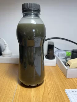

My next oil change at a 4,000 km interval (27,600 km) is imminent, perhaps in the next two weeks as days are getting warmer. This is when I find out if the mod I did late last year to try and hold the factory magnet more stationary improved the situation...
The suspense was killing me so I did the job at 27,435 km, 165 km early of my 4,000 km goal. Bottom line, I'm calling it a 'win', the oil was not tinged black this time but appeared more green, much like spirulina. Sloshed around in a pan it was golden brown and clean, could have been left in place far longer. Magnets had minimal iron as many others have found at short intervals.

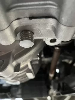

I used my inspection camera to relocate more precisely the external stack of magnets I had glued to the housing to better restrain the internal magnet. I added (2) more to make the stack 15mm high. A stack of (3) was only enough to just move move the internal magnet around so I'm thinking (5) should better restrain it against the influence of oil turbulence. There's about 9 mm of aluminium casing to get through so a strong field is needed.
If anyone else wants to replicate this the first issue is determining which pole goes up. The internal magnet could be oriented either way. It's not too hard to figure it out as when it's in the correct orientation at the position shown in my photo below the magnet will center itself and you can feel or hear the internal magnet following and moving in and out of its pocket as you slide the external magnet around, see short video here. So, you'd want to glue the external magnet as far away from the casing joint as it will comfortably sit so that the internal magnet stays hidden in its pocket.

Fill and drain respectively. This is exactly the quantity of metal I would expect to see given the duration.
New Penrite 70W-75 v.s. old. It looks dark in sunlight but not so under 3000K LED, below.
New location of magnet stack, moved 10mm in the 8 o'clock direction, a drop of epoxy holding the first one in place, cured overnight. This location should be valid for any Kona but not the Ioniq as it's different.
The next (4) disk magnets are just stuck on. These were expensive, $22 per 3, and seem to be among the strongest grade of neodymium grades. It's very difficult to slide any two apart.

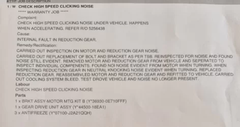

My WoF noise started early in the car's life, not long after I did the first oil change at about 2500km from memory. I would have done it earlier but I hadn't yet found this forum, its reports and its advice at the time.
I did further oil changes at 5000, 10,000 and 16,000 km. All drained oil was black with what appeared to be colloidal metal in suspension. I have reported this in these pages. The noise was intermittent and difficult to hear and was not present at the first annual service, so nothing was done about it at that time.
The second annual service fell due at 21000km. By this time the noise was pronounced. I reported it to the dealer who immediately acknowledged that there was an issue. They had dealt with one just before I reported mine, so I was pleased that I was not the guinea pig - the dealer knew the warranty drill, knew about the TSB and the workshop was familiar with the work.
They kept the car for a week, offering me a replacement (ICE) which I declined due to personal circumstances, and kept me informed. They isolated to noise to the GRU which was replaced. No new motor for me.
I asked for my magnetic plugs to be returned to me, which they did. They didn't seem perturbed about the fact that I had obviously been in there, changed the oil etc.
I suppose it remains to be seen how good this new GRU is. Will I be one of the lucky ones, or will the fault repeat? Will the oil go black? Etc.

I was wondering even today how this was progressing, especially since it's the only case so far of the WoF noise occurring on an example subject to preventative oil changes. I half thought you might have traded up for something else by now just to reduce the stress.
It looks like your dealer has provided the service we all expect and you were fortunate to still be under warranty.

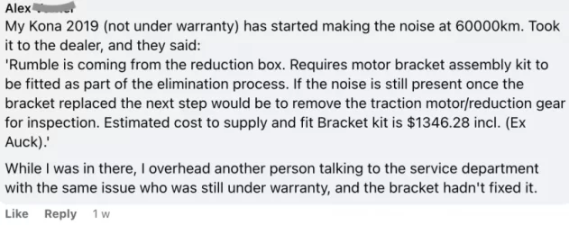

One less-fortunate owner here has been told by his dealer that just the first step in the TSB, the bracket change, will cost NZ$1346. This story is going to get a lot worse here before it gets better because there are many well-priced Konas on the used-car market now and most will be out of warranty. I see many innocent buyers asking about them on FB and I'm not sure if I should warn them away or let the chips fall where they may. It's as bad as climate change - no one really wants to hear the truth. The shame is that the Kona is a really good EV other than this one defect.
