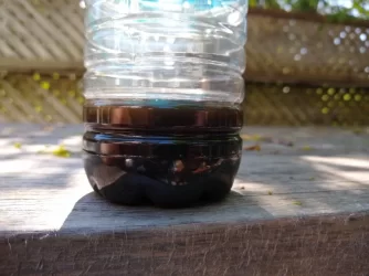

I just recently changed my reduction gear oil again, at 16,000km. Once again black as the ace of spades, as it was at 3000, 5000 and 10,000 km.

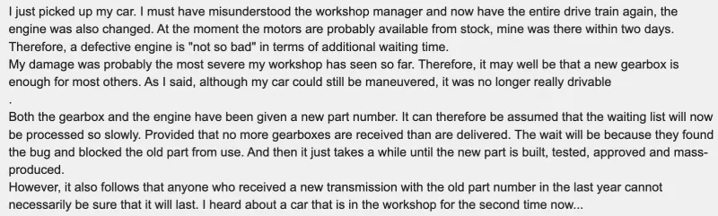

A recent recipient of a new powertrain in Germany was apparently told by their dealer that the many months of delay was due to the halted production of parts while further revisions were made both to motor and gearbox. We can only hope that's true and the new parts will be more reliable. From 6 June 2023, noting it's Google-translated:

My oil also turns black over any 4,000 km interval and the gearbox runs quietly. In another 800 km (at 28,600 km) I'll be able to carry out my next oil change and see if the oil has turned black again. I'm hoping not, the theory being that the magnets I glued onto the the outside are able to keep the internal magnet constrained enough to reduce the generation of aluminium contamination.

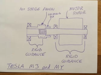

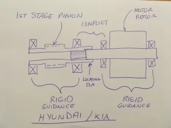

There's very little evidence to base any theories on but the few reports of the few rebuilt Ioniq and Niro gearboxes indicate that only new bearings were required due to roughness or complete failure, and in my opinion that's down to dirty oil alone. Even though the gears appear slightly lighter than I would expect at a glance, I haven't heard of any failures relating to their load capacity. The housing also appears a bit light with the risk there due to (a) tapered rollers used on the output shaft that push the cases apart under torque, and (b) the thrust loading at the input shaft due to the use of helical gears doing the same. But again the very few gearboxes we've seen opened up don't show any signs of failure related to those conditions.
As for shock loading it's true that the motor inertia is not decoupled from the gear train as it is with an ICE using a torsionally-soft clutch hub or fluid coupling. There could be considerable shock loading to gears but that would be more from hitting potholes than acceleration or regen profiles. The time duration of pothole shock loading is far shorter and the amplitude far higher than what you would feel when accelerating. But the engineers that designed the gearbox are well-aware of these requirements, size things appropriately and would have carried out significant laboratory and field testing. None of the used-oil analyses indicate oil oxidation which might result from the loss of oil film thickness at the tooth interface under excessive loading.
In general I think Hyundia's (MOBIS) experienced engineers would not have got the basic gearbox design wrong. The science and technologies of gearbox design are well understood and established in standards from industry groups such as AGMA. Mistakes are more likely to happen when other parties become involved who may not appreciate the fine details. A good example is the internal magnet. The Kia Soul EV has a custom square magnet with ridges (to increase surface area) and (appears) to fit closely inside the pocket in the housing. The Ioniq/Kona/Niro inexplicably use a round magnet inserted loosely in much the same pocket. I suspect that those engineers responsible for taking the gearbox design into production saw an opportunity to change to a far cheaper part and managed to get that seemingly-minor engineering change signed off by someone who did not understand the dynamics and implications of a loose magnet. It's certainly not likely obvious or predictable to even a trained and experienced engineer, you'd probably have to make that mistake once to find out.
The same understanding applies to alignment between the motor and gearbox where tolerance buildup must be minimised to ensure the splines are nearly perfectly aligned. This is important because of the design choice made where they have attached two completely-independent rotating assemblies together without perhaps fully understanding the implications of using a rigid splined coupling. Safely assuming that the motor and gearbox were designed by different groups, this is a failure of systems engineering. The risks they have taken are (a) spline damage or bearing overloading if misaligned, and (b) outer-race spin of the near side bearing at the gearbox input shaft due to geometric overconstraint resulting in insufficient radial loading which could cause wear and eventual excessive radial clearance to the housing. A spline is a traditional method of transferring power used widely in industrial machinery but I'll note that both Tesla (Model 3/Y and S-Plaid) and Hyundai/Kia (all E-GMP and the new Niro) have changed their designs to ones that just happens to avoid these two issues. GM and Ford (Borg Warner) didn't make these mistakes with the Bolt and Mach-E.
