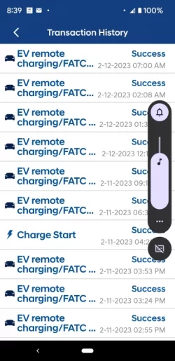

Here's a screenshot of my Blue link notifications. Is this constant charging typical behavior? I can't really see any pattern or reason for it happening.

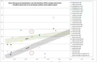

We have a new first time used-oil analysis to add to the collection, values circled for clarity. Those of course contribute to the trendlines, shifting the Fe line slightly upwards and the Al line slightly downwards.

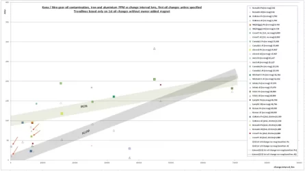

Thanks for posting the UOA document. Here's where you've benefited with that first oil change at 142 km. Almost 4,000 particles were found in a single millilitre! This is why I stress that an early change is important. If left in those particles would otherwise have been crushed by the precision ball and roller bearings and then shown up as higher PPM numbers. Bearings raceways suffer damage from this activity and you've avoided much of that.
Here's the updated graph with your results highlighted. We have good first-change coverage now from your 142 all the way up to 70,000 km. The three sets of second change data (with Votex) are coincidentally all clustered around 6,500 km.
Because the forum's image resolution is poor, I've placed a copy in my Goggle Drive public folder.
