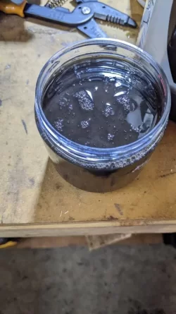

I finally changed the oil at 24000 km.
I put in Redline D6.
The old oil was black with a gray sheen to it.

With nothing much else to do on New Years Day I finally got around to changing the reduction gear box oil in my Australian 2022 Kona EV Highlander Extended range. I'd previously changed out the Hyundai oil at 142km and replaced it with Penrite Pro Gear 70W-75.

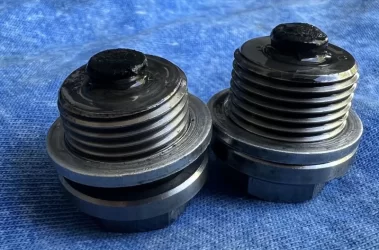

The car has now done 6630km and the oil was black and totally opaque. The two Votex magnetic drain plugs I'd fitted at the first oil change had a covering of fine metal particles.

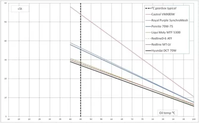

Another observation is that the original Hyundai oil was like water. The Penrite Pro Gear seems to have kept most of its viscosity. Not surprising given KiwiME's graph above.

Yes, you can see the Penrite gives you about a 15*C temp margin over the OEM, perfect for the Australian climate.
It’s cooler here but our road speeds are lower, often the limit is only 80 km/h so it’s perfectly fine because the maximum gear meshing speed dictates the appropriate viscosity.
The black oil seems to be caused by the loose internal magnet and whatever ferrous material it catches, in your case less because it’s only that not caught by the Votex first.
The best we can do is to adopt a suitable change interval in an attempt to keep it somewhat clean.

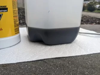

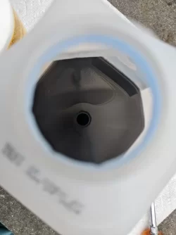

On January 2nd I changed my reduction gear fluid at approximately 10,000 miles (5,000 miles on oil) with the magnets external to the bolt. It didn't look as shimmery this time, but still looked fairly dark. This is my third change (1st at ~1K mile, 2nd at ~5K miles, 3rd at ~10K miles) and I'll likely wait until 25K-30K miles for my next one. For reference I own a 2022 SEL that I purchased in January of 2022.
