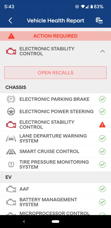

I just got this notification on my Monthly Health Report. My Blue link diagnostics say Systems Normal with no codes. Has anyone ever dealt with an Electronic Stability Control issue? Any idea as to potential causes? Since there's a disagreement between the report and the diagnostics I wonder if that means there's an intermittent fault.
View attachment 19929 I just got this notification on my Monthly Health Report. My Blue link diagnostics say Systems Normal with no codes. Has anyone ever dealt with an Electronic Stability Control issue? Any idea as to potential causes? Since there's a disagreement between the report and the diagnostics I wonder if that means there's an intermittent fault.
Maybe you spun the wheels a few times. It is still winter.
I wouldn't worry about it.
This is just a "report" which any temporary issue could have been resolved by now. That is of course providing there are no ESC warning lites on the vehicle dash. You could also manually disengage and re-engage with the push button left underside of dash. Should get a reading on the dash display when disabling.
Any chance of clearing that report?
I did all those things and there was never any warning light on the dash. So, ya, I'm just thinking that the monthly report might have captured an ESC activation but it's just history and not necessarily indicative of an ongoing issue. That's my hope anyway. I will ask the dealer to scan for and clear any codes when I do my tire swap next month.
