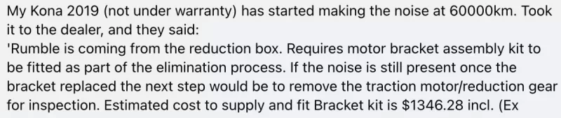

I'm coming up on 2 years being out of warranty. At nearly 28,000 km, 100% SoH, having 4 or 5 oil changes and with a stack of magnets placed under the gear reducer my Kona has never run as quietly and smoothly as it does now.
Yes I'm prepared to chance it, took the car on a run to the sons place 220km country miles each way, the GOM said 465 km range.
Ended up having to put in a charge on the way back, it would have only done 400km max, but the first and obviously last 120km were very hilly.
It is a great little car, but I will be annoyed if the WOF happens.

My advice on this tick tick issue, is document it well with your reporting it to your dealer before the warranty runs out. Then you may have a chance of it being covered after the warranty period.

The ticking started at around 90K for me. They replaced the motor mount brackets but that only resolved it for a few weeks. Next the reduction gear will be replaced, once the parts arrive, all under warranty.

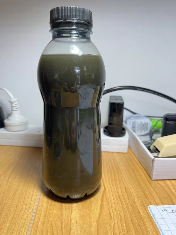

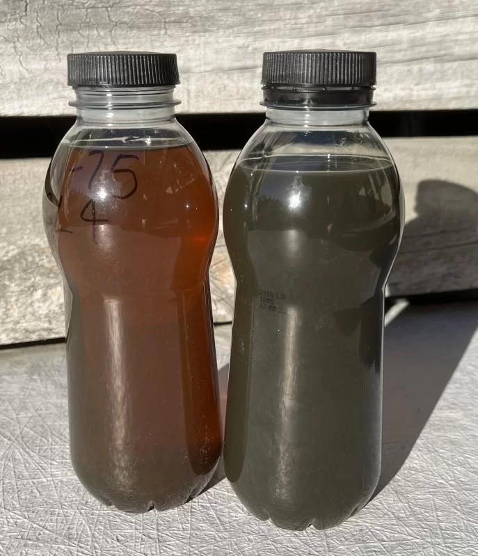

I changed the oil at 1000km. Black as the ace of spades with the same colloidal metal in suspension as per my post#225 on page 12. It's on its way to failure again, just a matter of time.
I don't think I want to keep the car any more. Will see what the dealer says, and may have to wait for more failures/attempts at rectification before commencing consumer action. Or sell it, with remaining warranty, suck up the $17000 loss it will cost me over my 2.5 years of ownership and get a 2023+ Niro. My son can lease one of those for me at very affordable fortnightly rates. Or I might get a mid-range EV6 for a few more $$.
With this drive train, plus the towbar issue, this car is not the right one for me.
The pic shows the colloidal metal in the oil:

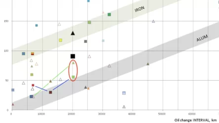

We don't have too many oil change reports at very low kms and your photo shows exactly what I feared, that the internal magnet isn't doing what it was intended to do, nevermind that Hyundai still don't realize this after 5 years. It's incomprehensible to me that ball bearings could tolerate that level of contamination without incurring life-threatening damage.
For the uninitiated reading this, if left alone those particles would disappear by around 20,000 km because the bearings and gears will chew them up into a black dust. But the bearing damage would have already been done and their lifespan reduced. If the oil was changed several more times at similar intervals, some or much of that damage could be avoided.

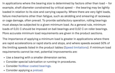

The other noise could very well be the motor tail bearing going south. I read that Auto Repair Videos reported that the hollow motor shaft rusts inside and those particles exiting the tail end had gotten inside the bearing. Noise reports of late from owners lead me to believe that the motor noise can be present at higher speeds and not only during regen.
I spend much of the day exploring the motor bearing application and sure enough it has a glaring deficiency, see below.

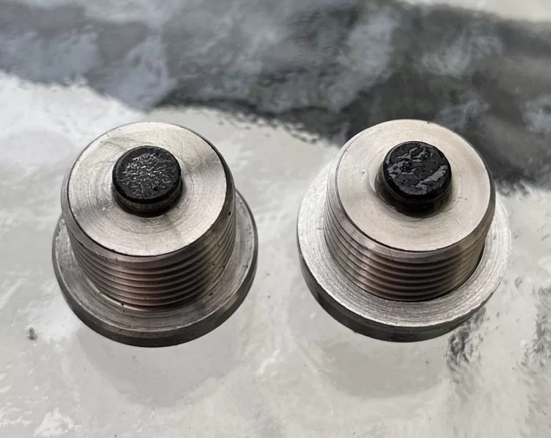

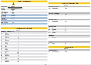

Just completed a gear oil change on our 2019 Kona EV at 89446 km , 20235 km on the oil since last change, magnets added to drain plug only at last change. Results here for KiwiME to add to the high end of the graph. Lower levels this time round but last sample had three times the km so not unexpected. Thanks for all the info sharing!

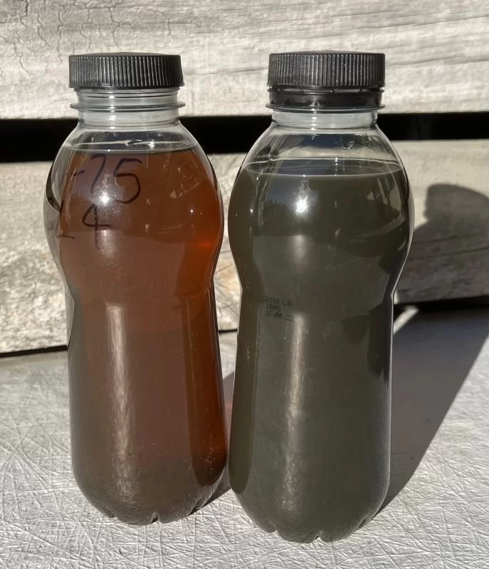

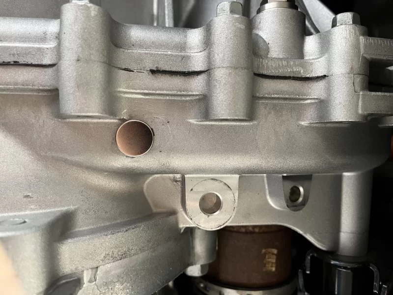

The suspense was killing me so I did the job at 27,435 km, 165 km early of my 4,000 km goal. Bottom line, I'm calling it a 'win', the oil was not tinged black this time but appeared more green, much like spirulina. Sloshed around in a pan it was golden brown and clean, could have been left in place far longer. Magnets had minimal iron as many others have found at short intervals.

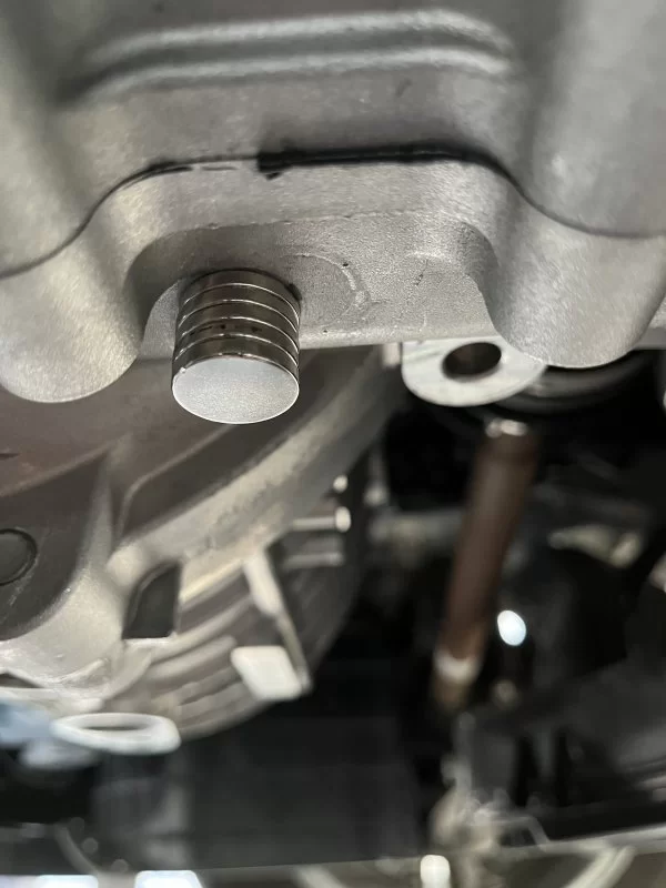

I used my inspection camera to relocate more precisely the external stack of magnets I had glued to the housing to better restrain the internal magnet. I added (2) more to make the stack 15mm high. A stack of (3) was only enough to just move move the internal magnet around so I'm thinking (5) should better restrain it against the influence of oil turbulence. There's about 9 mm of aluminium casing to get through so a strong field is needed.
If anyone else wants to replicate this the first issue is determining which pole goes up. The internal magnet could be oriented either way. It's not too hard to figure it out as when it's in the correct orientation at the position shown in my photo below the magnet will center itself and you can feel or hear the internal magnet following and moving in and out of its pocket as you slide the external magnet around, see short video here. So, you'd want to glue the external magnet as far away from the casing joint as it will comfortably sit so that the internal magnet stays hidden in its pocket.
I've used up my supply of oil and given the good results am unlikely to change it again. Chances are I'll be driving another EV in 2-3 years.
Fill and drain respectively. This is exactly the quantity of metal I would expect to see given the duration.
New Penrite 70W-75 v.s. old. It looks dark in sunlight but not so under 3000K LED, below.
New location of magnet stack, moved 10mm in the 8 o'clock direction, a drop of epoxy holding the first one in place, cured overnight. This location should be valid for any Kona but not the Ioniq as it's different.
The next (4) disk magnets are just stuck on. These were expensive, $22 per 3, and seem to be among the strongest grade of neodymium grades. It's very difficult to slide any two apart.

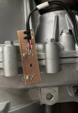

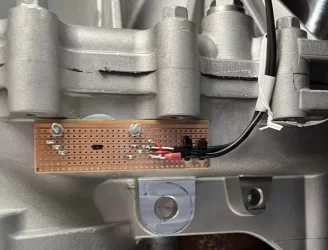

Regarding the GRU oil contamination problem, I've been wanting to 'prove' that the factory internal magnet moves while driving due to oil turbulence. I had an idea for a sensor a few months ago but had delayed putting that into action due to the effort required. But recently I thought I would do the software component of that as an exercise, only because I needed a simple display application to help develop my hobbyist-level Arduino programing skills.
That turned out to be easier than expected and since I already had the remaining hardware, I really couldn't find an excuse to avoid finishing the job.
Apparatus
The basics are that I have two linear Hall sensors that provide X and Y data for a graph. Both sensors have a steel screw placed behind them to focus the field lines though the sensor, which significantly increases the sensitivity. They are sensitive enough to detect the change in a magnet's field when it translates or tilts, including through the aluminium housing. However they can't detect a pure rotation (spinning) component because that doesn't cause the axisymmetric field to change on a round or toroidal magnet.
The Hall sensors respond to static north and south magnetic strength (gauss) as deviation (positive or negative, respectively) either side of a nominal 2.5V. Passed on to (2) analog inputs on an ESP32S3 microcontroller development board, those analog signals are read every 25ms, autoscaled and mapped linearly to the display pixels as a large dot. There is a tracer line that tracks the last 1.25 seconds of data to help understand the recent X-Y pattern. Note that the pattern on the graph doesn't necessarily translate to the magnet's actual spatial movement, it's just a visual indication that there is movement.
The first video shows what the GRU magnet looks like when influenced by an external magnet with no oil present. It has limited room to move in all directions.
The second video shows testing the apparatus using a drill press to simulate a wobbling magnet. It worked exactly as I had hoped, automatically scaling the signal's range to fit within the graph area. The numbers on the graph are meaningless, that was just part of the programming lesson.
Test Procedure
The board holding the sensors was attached to the GRU underside with Blue Tack. While installing the sensors I was able to verify that the magnetic field was present and readily detected by both sensors. I'll note that the autoscaling is one-way, it will fit the largest signal found during the session and not return to a finer scale unless a button is pushed to reset it.
The third video shows the first road test in the Kona with the sensors oriented to detect magnet motion side to side in the retention pocket.
I did a second run with the sensors placed at 90°, to detect the magnet entering and exiting the pocket. The outcome was much the same as the first, so I didn't record the second run.
Results
The result in both runs is that there was no evidence that the internal magnet moves while driving. All motion on the display could be attributed to electrical noise or extremely small movements. If there were larger movements the scaling would zoom out automatically to accommodate them, making subsequent steps smaller in movement. The large jumps indicate that the signal changes are very small.
There only remains the possibility that the magnet is spinning but I doubt that it could do that so perfectly that there were no associated and detectable translation or tilting artifacts.
Conclusion
We now have far less plausibility to the theory that the magnet catches, grinds down and releases wear particles once they lose their magnetic attraction. And we don't have a good reason why the internal factory magnet can stay relatively clean over tens of thousands of kilometers or miles. It should catch most of the particles soon after they are generated and hold onto them for the life of the car, looking like a steel hedgehog.
This doesn't change the reasons to change the oil very early (500 km/300 miles and 1,500 km/900 miles) and at scheduled intervals far less that the factory recommendations. We know that the GRU suffers damage due to inadequate particle retention but we don't yet understand the role the magnet plays in that.
