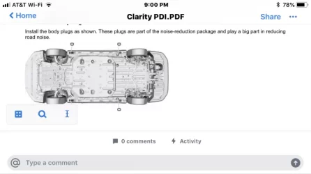

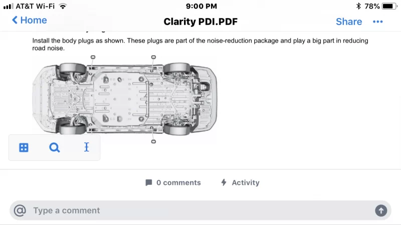

Hello KentuckyKen, would you take a picture of the 4 body plugs and where they are located at? I am experiencing road noise and perhaps mine has the same issues. Thanks!
Here is the diagram from the PDI.
The rear ones are hidden directly behind the angle iron weld on forntjt jack point. The fronts are about 6” from body edge. Despite what the PDI said, I find they seem to make only a small difference in sound level.
