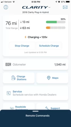

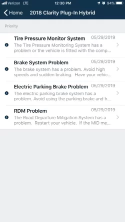

Wow this is a long thread. I'm sad to say, this thread lives on. I had leased my Clarity less than 2 months ago and I'm receiving a ton of warnings and errors (TPMS warning, Break System Problem, Electric Parking Break Problem, RDM Problem, VSA Problem, etc.) along with my gauges lighting up like a Christmas tree. Weather in Southern California has been nice (high 60s to low 70s) so I don't think weather plays a factor to me. I initially thought it was a power surge from the 240v public charger that I was using when I got the error codes (after disconnecting the 240v public charger and starting up my car). I did back up abruptly after I started up the car, so I'm not sure if that plays a factor in this. I made an appointment with the dealer to get this checked.
For those that went to the dealer, did they charge you a fee? I hope not! Should be covered under warranty. Also, for those that have the HondaLink app, did this clear your notifications?

I had two very similar incidents way last summer, which at the time, were cleared by a hard reset by removing the negative cable from the vehicles 12V (NOT the high voltage) battery. But, in the meantime Honda has since issued several service bulletins for software updates to solve these and other issues. It would be very unsatisfactory if the leasing dealer you dealt with just a couple of months ago did not apply those s/w updates before pushing you out the door, but I can see where it could happen.
Take your car to a dealership to see what updates have already been applied. All of this should be free of charge and covered by warranty. I don't remember offhand the service bulletin numbers, but these can be readily found on this forum in several spots. If you still have issues finding them, PM me and I will dig them out for you.
