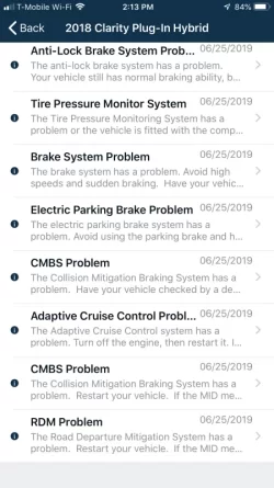

Wow this is a long thread. I'm sad to say, this thread lives on. I had leased my Clarity less than 2 months ago and I'm receiving a ton of warnings and errors (TPMS warning, Break System Problem, Electric Parking Break Problem, RDM Problem, VSA Problem, etc.) along with my gauges lighting up like a Christmas tree. Weather in Southern California has been nice (high 60s to low 70s) so I don't think weather plays a factor to me. I initially thought it was a power surge from the 240v public charger that I was using when I got the error codes (after disconnecting the 240v public charger and starting up my car). I did back up abruptly after I started up the car, so I'm not sure if that plays a factor in this. I made an appointment with the dealer to get this checked.
For those that went to the dealer, did they charge you a fee? I hope not! Should be covered under warranty. Also, for those that have the HondaLink app, did this clear your notifications?
PeterK909 - My gut feeling is that the dealer did not fully charge the 12 volts battery (not the big 17 KWH propulsion battery) when they delivered the car to you.
And if you don't drive the car a lot (it is not ON), then there is less chance for the car to get charged and many of the computers sensors on board need the 12 volts battery to provide good juice and it isn't. I would ask the dealer to make sure the 12 volts battery is good and fully charged.

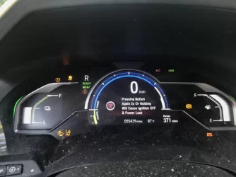

Hey there. My situation might be different but here’s what happened. I Uber in my Clarity. While driving someone last night I hit a relatively small hole in the road but it was the perfect size to trap, pinch and destroy my tire.
Well. It actually took out both right side tires!!
I drove it home 2 mi slowly with no issues.
They wanted over $100 to bring a flat bed. So I drove to tire place. Maybe a mistake. The front right tire basically was off the rim. All of a sudden all the warnings appeared.
When I got there I noticed that I destroyed the shield around the tire. Also a plug was unplugged. I plugged it back in hoping all would be well. Not so
I got 4 tires. But errors still showing. Tried disconnecting battery. I only did negative though.
Any advice??? I can’t see anything disconnected by the tire. Don’t really want to goto dealer and have them yell at me.
Thanks. .

I now get this also when shutting off car

IMHO, this situation is outside the experience of most, if not all, of the forum members. Your last posted screen shot shows over 55,000 mi. on the odometer, which I am guessing far exceeds most of us (not that this is the only or determining factor). I would suggest you take the car to a dealer with some Clarity expertise and get them to evaluate your specific situation and how to fix it. No dealer should "yell at you" for this.
I suspect there was damaging to the wiring, probably the wheel speed sensor, when the plug was forcibly pulled apart by the destroyed tire. The dealer may have to replace that wiring harness, the wheel well shield, and a wheel (if the tire was so far gone it was riding on the rim). Don’t be surprised at a big bill from this and see what your insurance might cover.
The rim is fine. New tires on
Going to dealer on Friday. Hope it’s not too expensive
