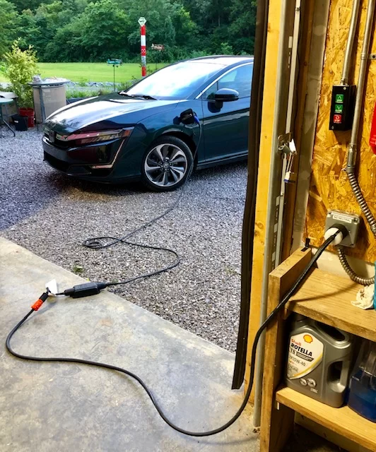

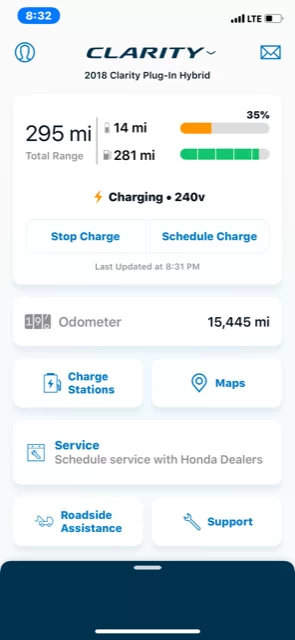

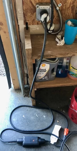

Well, I finally built up the nerve to plug in my 240v adapter cable to Honda’s stock 120v charging cable:
Light comes on as normal, and nothing has caught fire or blown up. Yet. A good sign.
Our Clarity is fully charged. I may run some miles off it, then try a 240v charge. Wish me luck!
That's terrific. I'm sure you are monitoring the temperature. By feel is okay but IR thermometer guns are like $25 on Amazon if you don't have one already, makes it easy to regularly check the temperature of the box and all of the contact points, especially for the first few days. One thing you can do is to measure it cold, then during charging see if one section warms up a little faster than the others, most likely normal but at least you would know where some of the heat might be more concentrated.

Fingers crossed, so far, so good!

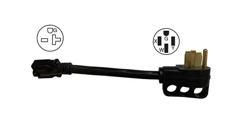

The NEMA 14-50p to 6-20r adapter has a 12" cord, I think 10 gauge wire. It never gets above ambient room temp while being used. Is it UL rated? Doubt it.
https://www.amazon.com/14-50P-6-15R-Adapter-Adaptor-Charger/dp/B07HX9JCC4/ref=sr_1_3?crid=G4WRGMZJ8LKO&keywords=nema+14-50p+to+6-20r+adapter&qid=1561731713&s=gateway&sprefix=nema+14-50p+to+6-20r,mobile,145&sr=8-3
Doesn’t look like that will work with the stock charging cable’s plug, if that’s still what we’re talking about.
