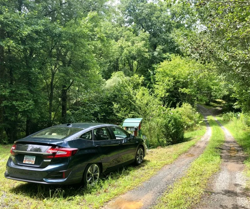

I’ve said before that our need to quick(er) charge would be few and far between.
But as luck would have it, the day after my N GA install, a case presented itself. We started the day with 51 EV miles and had to do some local running around, which left us at 19 EV miles remaining when we got home. We had about 2 hours before leaving for TN, and plugged in down at our RV pedestal, about 200’ down our driveway...
In any case, in the two hours we picked 22 miles of range, going from 19 to 41 EV miles remaining. At least double what we would have seen at 120V. Not a huge deal at today’s gas prices - roughly half of our 90 mile trip is on gas anyway, but still a benefit.
Glad I did it, and thanks again to all for the inspiration!

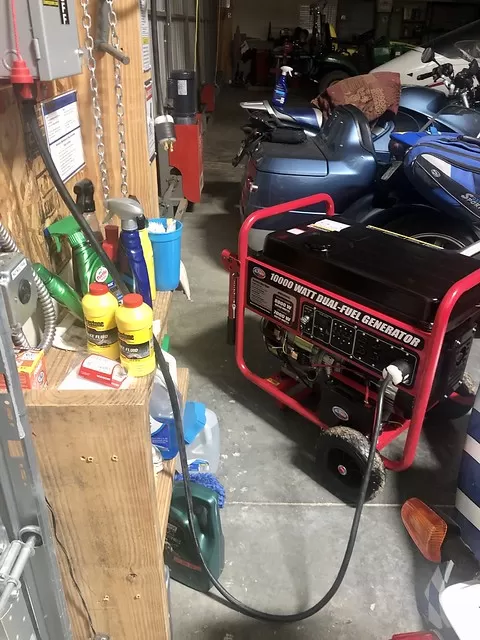

I'll believe it when you tell us you have a power-cord adapter.
I got it. Your way has no possibility of back feeding the grid, requires no transfer switch, and uses a regular generator cord that is safe with no exposed prongs. Excellent DIY engineering. I’m making a note of that in case I ever need to copy it.
Finally got around to purchasing a generator of adequate capacity, and I’m proud to say it opens and closes the hangar door with no muss or fuss!
As an aside, maybe a dozen or so more 240v charges with the stock cable, all to no ill effect.
Nice genset. Boy, you and Karen have a lot of toys for riding and flying!
