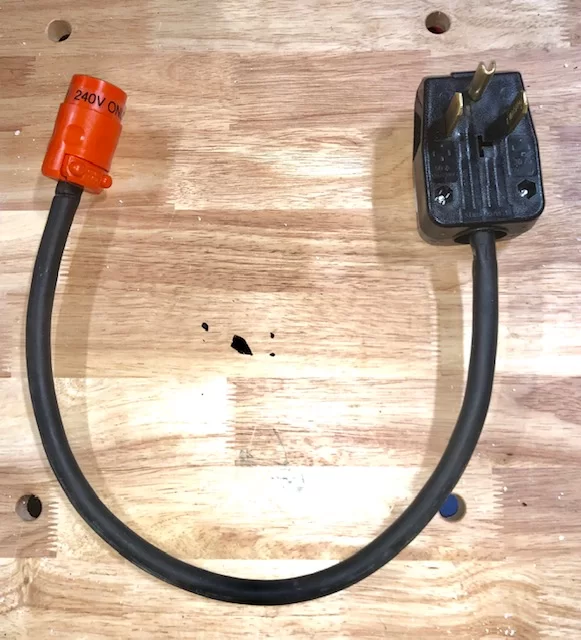

Got the 14-50 plug yesterday and wired it up today:
I had the inline 120v receptacle and the cable lying around. I left off the neutral spade since it’s not used - just two hots and a ground.
I plugged it into one of our RV pedestals and it tests OK. The only thing a little odd is that I’m measuring 260v across the spades and 130v between either spade and ground. At the house it’s more like 245v and 125v respectively at our 30A outlet there. I’m guessing it might be because of the heavier gauge wire running to the RV yard and maybe the fact that it’s closer to the transformer.
Does that sound right?
Neutral pin might have helped with support, did you just feel it was safer not connecting to the RV outlets neutral? Or maybe just another visual reference that this is not an ordinary cable?
This. Just a reminder no neutral is involved. The plug engages very solidly without it.
Pretty academic, I think - I don’t expect anyone other than myself to use it, and then only rarely.
Today we had our first chance to try out charging from zero to full using the 240v adapter cable and stock charger.
1) It took about 5 1/2 hours in 90° heat.
2) Nothing got any warmer than usual.
3) My house didn’t burn down.
I’d call it a success!
I’m still surprised that anyone would sell a device that feeds 240v into a receptacle designed for 120v. The potential liability seems huge. I fully recognize the risk that exists for the two adapters I fabricated, but attempted to minimize it by clearly marking the female end “240V ONLY!!!”. That, plus the fact that I’m the only one using the adapters makes that small risk acceptable.
But before buying one, I would make absolutely sure it does what you think it does - feeds one 120v leg into each blade socket of the 15A receptacle, plus the ground to the ground socket. Otherwise it accomplishes nothing other than letting you tap 120v from a 240v receptacle - and without a separate neutral, which itself can pose its own hazards and problems for circuits that might be GFCI protected.

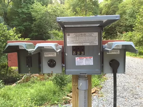

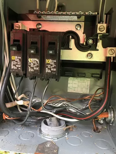

We also have a home in N GA. A few years ago we installed an RV power post some distance from the house to power our travel trailer or guest’s RV’s:
We installed a 20A outlet and two 30A RV outlets, protected by these breakers:
The whole shebang runs through a 70A breaker at the house.

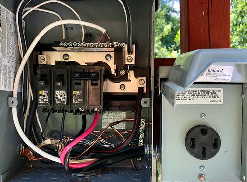

Yesterday I spent just under $30 at Home Depot for a 14-50R receptacle, a double 50A breaker and some 6ga, 3 wire cable with ground. Replaced one of the 30A outlets today:
I’ve already fabricated an adapter to power the stock charging cable from a 14-50R outlet with 240V, as mentioned upthread.
The times we may need quicker charging than 120V provides will be few and far between, but it will be nice to have the option.

Nice set up and although I’m not a licensed electrician, but it looks Kosher and all according to Hoyle. Did the additional 50 Amp circuit keep you under the Ampacity of the length and size of the feed wires from the house?
