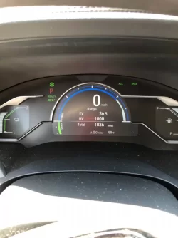

I've noticed this issue as well, but today was a new one for me. I filled up the tank after driving over 1000 miles (personal record for me, I drive a lot for work)
After getting gas I happened to to notice what it said my HV range was and thought I would share... 1000. Somehow I don't think that's accurate lol
What's funny is it goes to 1000, which is 4 digits long, but I haven't seen it go above an even 1000, so why not just stop at 999 and skip the fourth digit? That seems like extra effort to put into a number that is completely broken anyway.
