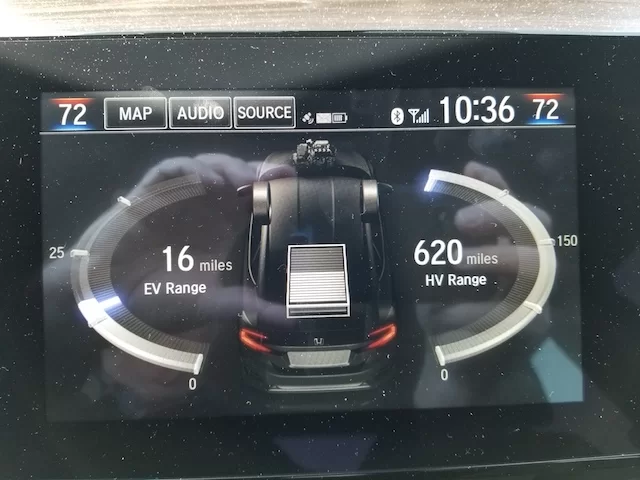

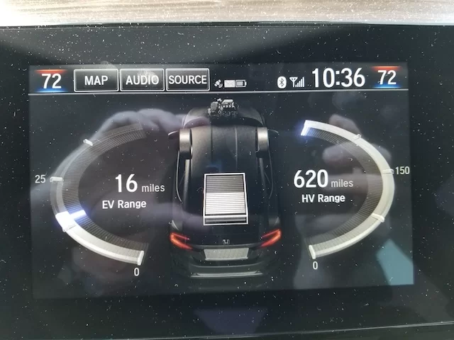

Just for fun, I put in a couple gallons of gas to top off the tank. Here is what I see. Subtracting 16 from 620 = 604. 604 divided by 7 gallons is 86.29 MPG. There is no way this car is getting 86 MPG in HV mode. I think the calculation is including the 199.9 "fake" HV MPG from when we run in EV mode, which is most of the time for many of us. Since the main dashboard display also displays the total range (e.g. 636 miles), this is not a "nice to have" feature show on some eco screen buried in the menus. I consider this a primary piece of driving information for the driver.
I will reply back to Honda that my dealer says they are not aware of a Honda-provided fix for this issue.
This might be a dumb question, but how do I get that display on my main screen? I have only been able to get it on the instrument panel screen.

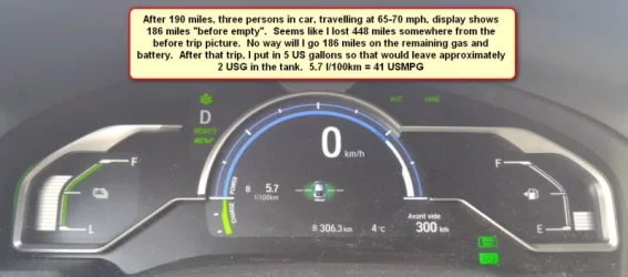

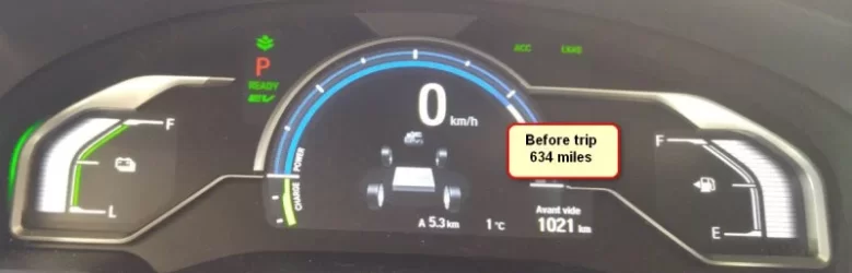

On that subject, here are the before and after trip pictures of the display. From what the dealer tells me, it's that the computed value of "before empty" is based on the previous distance vs charge vs gas put in. I tend to agree with this as this value has been increasing from day one. This is totally bogus and my personal view is that what is shown in the display should be "actual" numbers based on EV and HV range.
