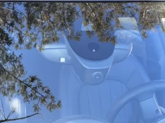

To add to the camera interference, it's completely separate from the camera-guided adaptive cruise control, and has not had any impact on it's performance, the wipers, etc. I attached a pic, you can see how it is not in FOV. It does NOT have GPS data, and does not record speed (a good thing, for me :D) Night vision is quite good, it's not infrared, but shows things well that are illuminated by your headlights. I'll try to get a capture for the rear, as I haven't really looked at that in the dark. Actually, just found a video in the dark with the rear, there's a fair amount of glare from approaching headlights, and you probably couldn't detect a license plate number at night.
