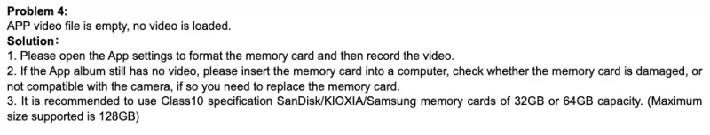

Well, if anyone here has learned anything about my posts, it is to completely disregard them, for at least a week!! The ONLY issue with the FITCAMX is that it apparently doesn't reliably support cards >128GB. I discovered that with my 258GB card it was missing about 20 seconds of capture every few minutes of recording. The video is great, and reliable, but once I realized this and plugged the included 64GB card there was no issue. The good news is even the biggest card is <$20, and I can still use it in my DSLR or drone. And if this reaches you, can still be returned to Amazon. Or feed it to your rabbits. The other good news is the FITCAMX support team is wonderfully responsive, and if I had discovered the problem would've told me immediately. They will also happily guide you through any questions regarding installation, fitment, etc.
Bummer! I noticed the Aliexpress page for it indicated a max SD card of 125GB, and thought you had mentioned 256, so I was going to ask if that was actually working out for you.
That being said - you should be able to move up to a 128 from the 64 they include, no?
Lol I gave the video a like the very first day
It is indeed the size of the card, and yes, I confirmed with them the Max supported is 128GB. Must've missed that on the website. The 64GB class 10 is working fine. You definitely want to get a class 10, they'll specify whether they're meant to work with 4K video.
Strange it’s size limited to 128GB…
Last time I heard of that limitation was probably 20 years ago when the old ATA interface only used 28bits of the addressing space or something like that and thus maxed out at 128GB.
So sounds like some of these embedded electronic devices might be using some old standard (I know CF cards are essentially IDE but didn’t think SD cards were)…

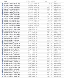

  • I see that it recorded for 3min at 2am when the car was definitely parked and not plugged in... why'd it do that? (see attachment)
