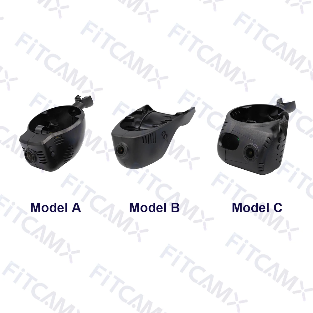

For 2023 SE - what model to choose?
Yep, B. Also, ordering from AliExpress took 2+ weeks so don't regret your source. Scoot the seat forward while installing to avoid the c-spine strain. It's not as bad as it seems. Glad you guys are jumping on board AFTER the upgrade to allow 3 minute videos. Really love this camera, need to break myself from the addiction of reviewing A-holes on the road, which I now notice far more often, just so I can curse them in the post-production after party...
