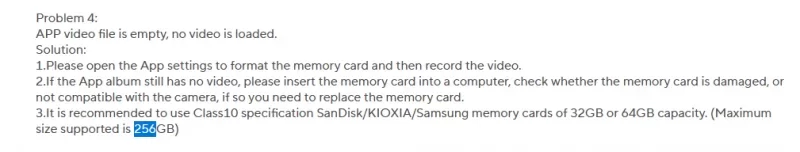

Well, if anyone here has learned anything about my posts, it is to completely disregard them, for at least a week!! The ONLY issue with the FITCAMX is that it apparently doesn't reliably support cards >128GB. I discovered that with my 258GB card it was missing about 20 seconds of capture every few minutes of recording. The video is great, and reliable, but once I realized this and plugged the included 64GB card there was no issue. The good news is even the biggest card is <$20, and I can still use it in my DSLR or drone. And if this reaches you, can still be returned to Amazon. Or feed it to your rabbits. The other good news is the FITCAMX support team is wonderfully responsive, and if I had discovered the problem would've told me immediately. They will also happily guide you through any questions regarding installation, fitment, etc.
The description now states 256gb supported.
