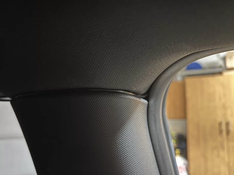

I just tucked it under the roof liner. You can pry off the anthracite liner to get it all the way under. View attachment 16192
