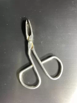

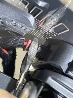

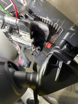

First post here, thanks everybody who had posted on this thread, learned a lot. Took the plunge and ordered the FitCamX (4K front only model B) from the FitCamX store on aliexpress for my 2022 Cooper SE, shipping was quick, took only 11 days. The OEM look is the main reason I chose this cam but the clarity of the video is amazing, you can make out the license plate of the vehicle in front of you at a stop! Installation was straight forward. I would like to offer a couple of tips from my own experience, hopefully they'll be useful for somebody. Unplugging the existing red connector to the rain sensor was pretty hard mainly because there isn't much room to work with and it sits pretty firmly in place, so I unplug the other bigger connector below it first. Then I used my wife's eyebrows tweezers to grab it, as you can see from the pictures, the tweezers has an angle to it, comes in handy when you are grabbing it from the side. After connecting the wires, you just need to snap the 2 halves back together, pretty easy.

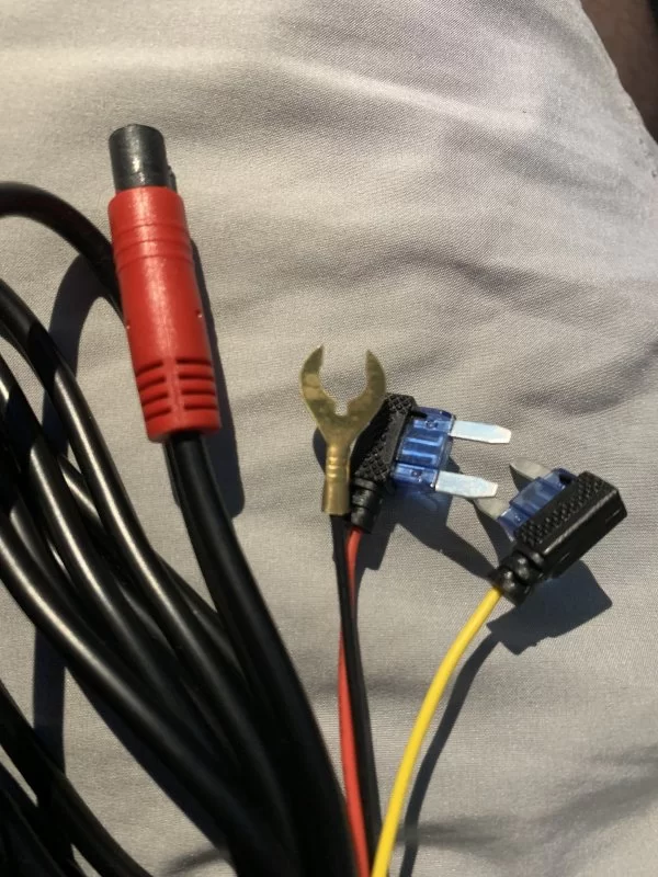

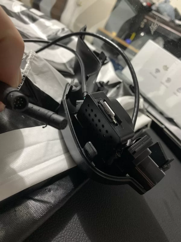

Thats what I ordered so they sent me the wrong thing
Ah - that stinks. You'll have to reach out to them and include pictures. I'm sure they'll get a replacement out to you. (I ordered mine from Aliexpress and the wiring harness was bad, they sent a whole new replacement).
