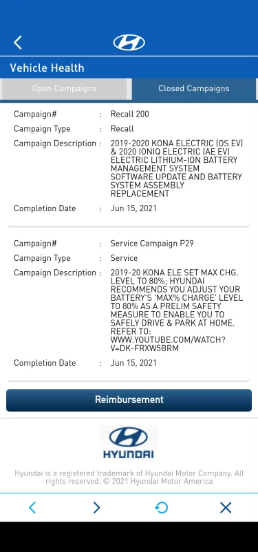

I took my 2019 Kona Ultimate to my local dealer and had all of the recalls, campaigns and service bulletins taken care of last week.
When I checked the "MyHyundai" app, all of the work that was performed at the dealer showed up as completed.
I thought that that would be a good thing so I called Hyundai customer care at 1-800-633-5151 and they also confirmed that no other repairs were necessary. So I questioned the battery replacement. They said that the dealer performed an inspection / battery check and it passed. They also explained that there is no reason for them to replace the battery at this point. I continue to ask them for more information but they had nothing to add. I question them about charging to 100% and they told me I could without any issues or concerns.
So at this point with no warranty repairs necessary and no reduction in state of charge to 80%, I now have the full use of the vehicle I purchased and enjoy driving, AS IT SHOULD BE!

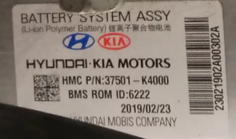

If you look at the sticker on the battery (you will have to get down on the ground near the rear left tire), you should be able to see the date that the battery assembly was manufactured. It won't be all that easy to spot, but all you will really need to see this is a flashlight. Or a smartphone with a flash. If I were you, I would make an effort to get a photo of the sticker and post it here.
Here you go.
Oh, wait - I am off by a year. They introduced the change in March 2020, but your battery was made in Feb 2019.

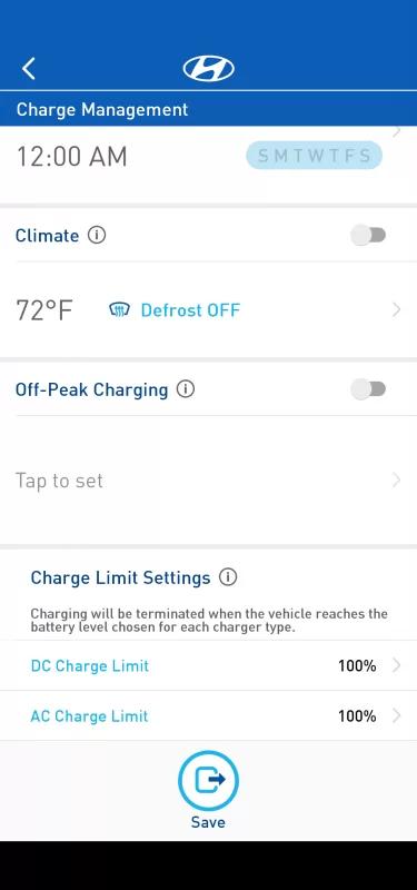

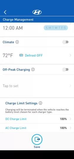

While checking the MyHyundai app I noticed that the charge management used to select the percentage of charge on DC and AC can now be set to 100% on my Kona. I was told by the Hyundai service center that I could charge to 100% and the app now reflects that. I hope they know what they are doing!

I received an email from Hyundai stating that it was included in the recall, it showed up on the NHTSA recall list when I entered my VIN number and when I brought it to my dealer for service it showed up on their list as being an incomplete recall for my vehicle. Now when I check for any open recalls anywhere, it shows as zero open. When I check on the MyHyundai app, with my VIN number, it shows all of the recalls as being completed.
I would call Hyundai, it's very confusing that they would including you in P29 which set the max charge to 80%, then change it back to 100% without changing the battery. Personally I would want something in writing as to why they think suddenly just a software change fixed the problem. In other words why were you suddenly now told you could safely charge to 100%, what changed? (is it REALLY 100% or is it lying to you? I mean, did they move the goalposts? If you charge to 100% is the GOM what it used to be for 100% ?)
Yes it did.
It appears like your dealer incorrectly "completed" recall campaign 200 as its unlikely he replaced the traction battery as listed in the recall language without your knowledge.
Excellent point, Apu. 200 specifically says "and battery system assembly replacement" - it doesn't sound like that happened. I mean I'd hope they would have told you if they replaced the entire battery pack.
Joev, you said "I hope they know what they are doing", I think equally relevant would be, this which I say to you: I hope you know what they're doing (and did). I would definitely be on the phone with Hyundai and the dealer, today.
