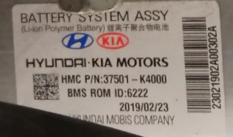

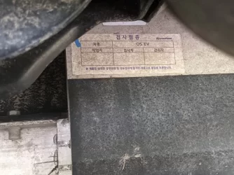

I don't have any way to lift the car but I have crawled under and contorted myself and could not see this sticker anywhere on the visible sides of the battery casing. This is the only one I could see. Can anyone translate Korean?
