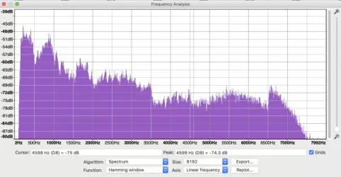

Since I can turn the VESS off I did and held my precious phone out the window and recorded the spectrum below while accelerating past a wall. I do admit to some deafness but I certainly can't hear any sort of switching noise, nor anything amiss. As for the heat pump, if it's 'off' it's really off. This just looks like general noise, nothing outstanding. Unsure what the bandwidth is of the mic, but the file is 32-bit 16kHz. I'll find a quiet, steep hill and try again under high load at very low speed to minimise background noise.
Thanks for doing this! Since KonaTom and MGrognon are reporting this whining in parking lots and driving in and out of dealers, I am not sure it is worth it for you risk your phone and safety to find a hill and put the car under load. I appreciate your input.

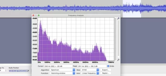

Yeah, the jet noise is cool. It sounds like torque ripple from the motor with a bit of gear whine, both seem normal although I don't have experience with other EVs, just machinery in general.
I'm assuming the complaints are resulting from higher frequency noises, closer to what the VESS sounds like, switching frequencies or harmonics of those.
Here's another with sound file. Not sure why the roll-off under 8kHz, could be the mic. Sorry about the damn birds chipping, I thought it was a quiet hill.
