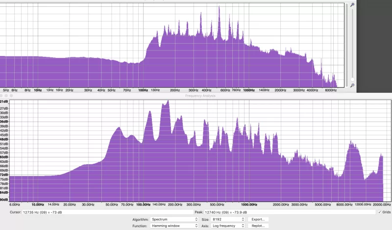

I did have a look at the spectrum and there is significant noise above frequencies that the VESS produces. You really should make a recording with the VESS unplugged to make any sense of this. My VESS is the upper graph recorded when the car was stationary, see image. Your VESS may be different because the car is 'moving'.
That’s super interesting, but as you mentioned, I think it’s a different level.
The VESS increases in volume as the vehicle increases in speed. It shuts off at 40km/h (here in Canada at least) When driving with windows down, the high-pitched sound is still audible after the VESS shuts off. Especially if I remove my foot from the accelerator and let the regen kick in.
