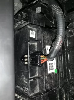

Yeah, I almost unplugged the VESS, but I was worried that it would throw a DTC and the dealership is two hours away :p Can anyone confirm that the car doesn't notice?
I'll try to talk my coworkers into redoing the test with me soon.
According to other posts you’ll simply get a “VESS malfunction” error of some sort, but that’ll clear when you plug it back in. Doesn’t sound like a trip to the dealership is necessary!
I've unplugged it 3 days ago and never got any error, even ran a diagnostic and the car didn't report any malfunction.
Is that the plug/connector(looks like about 4 wires) way under the gap at the front end between the hood latch and the rad? (picture?)

No it can be heard over the VESS sound. As I recall it is also present when VESS shuts down after 38kph. I intend to unplug the VESS module and give it a try when the weather improves.
As an alternative to finding and unplugging the VESS connector, you can also just temporarily pull the fuse. It's under the fuse cover inside the cabin. Look in the owner manual and you will see a diagram of which fuse is used by VESS. Unfortunately, that fuse controls a larger module of electronics so you will also lose some other non-essential functions of the car (smart cruise, etc.) while you do your noise testing.
