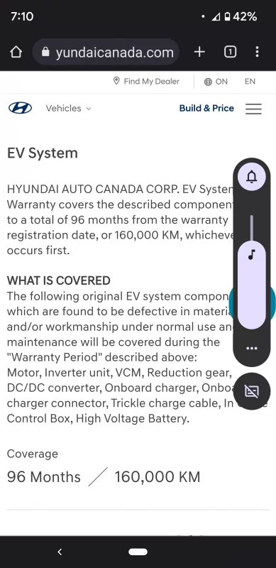

I'm also just hesitant to keep the car after the lease ends 10/2023, since I'm not confident it will not happen again. Is this something covered under drivetrain warranty? (I may not be identifying that correctly by name).
The entire drivetrain is covered for 96 months or 160,000km.
* Canada
Better check again...according to my 2021 manual (page 5-service passport), the powertrain warranty is 5 yrs/100,000 km.
The EV system and (FWIW the hybrid and plug in hybrid system) do carry that 8 yr/ 160,000 km warranty.
I did pay for the extended warranty (8 yr/ 160,000/km) which does indeed cover transmission ;)
Here's the page. Is it because mine is a 2019?
