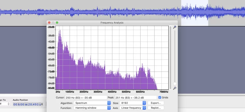

I had another poke around the audio from the SeanH video and there are four distinct regions of noise:
A) below 200 Hz, presumably the rumble of the mechanicals
B) the VESS which ranges from 200 to 7,000 Hz which has an additional unidentified component perhaps related to C and D
C) lower 'switching' (for lack of a better term) noise centered around 9,700 Hz
D) higher frequency 'switching' noise centered around 17.6 kHz, noting that the mic appears to roll off after 18.5 kHz
The mp3 I provided earlier is of C and D, noting that I can only hear D separately if I use high-spec earphones and turn up the volume.
Looking at B again, check out the MP3 below with a high-pass filter above 2,400 Hz instead of 7,000. That leaves much of the unidentified component and higher 'switching' frequencies with the VESS less intrusive.
