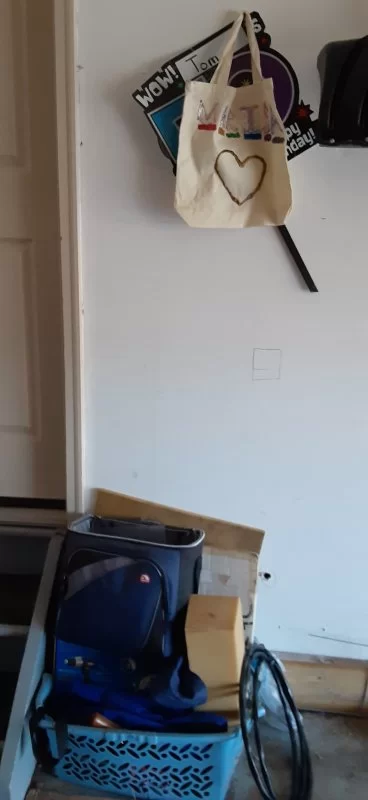

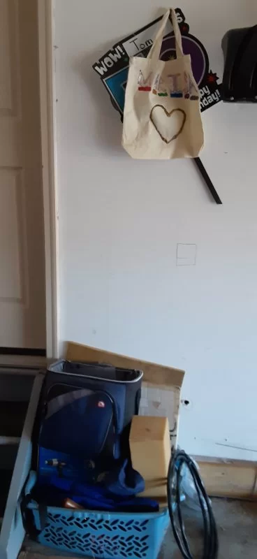

The prior owner built an extension and the breaker box is in the basement by the garage. I drilled the hole and bought 6 gauge wire. Now I have to decide if I am going to open up the sheetrock or try to snake the wire between the wall since I want the outlet about chest height.
Bottom is the hole to the basement, about where I want the outlet is outlined above the hole.

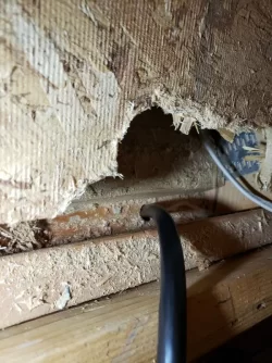

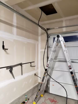

I ran 6/3 wire up from a breaker box, through an attic, and down through a wall. The only holes I had to cut in the drywall was for access into the attic section and the hole for the outlet. Definitely not easy but doable.
I used a combination of a "steel fish tape", a scrap solid core copper ground wire, and rope to get mine pulled through the wall. Basically I got the rope routed through the wall with the fish tape and copper wire hook then taped the 6/3 wire to the rope and pulled it back through.

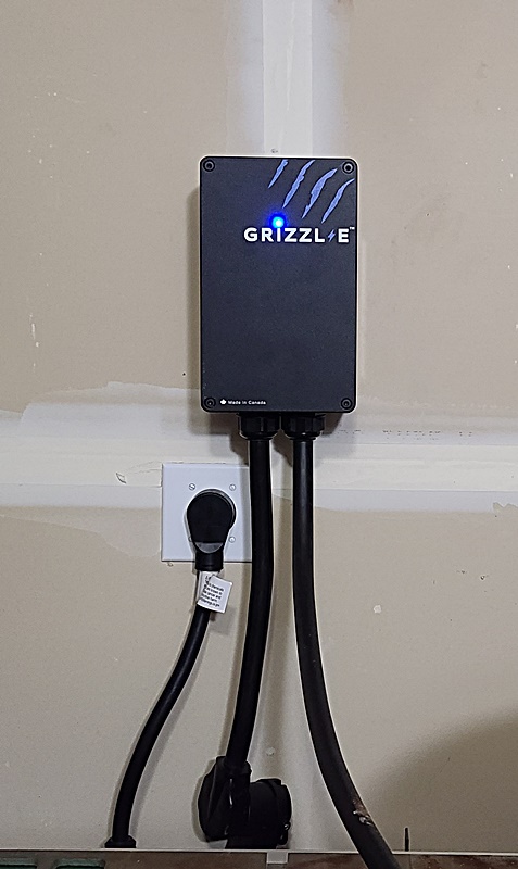

Expecting my car to arrive this week, so I finished working on the garage so I could get to my 240V outlet, then I installed the old Grizzl-E Smart. (not really old, but I HAVE had it for over a month).
Have not connected it to WiFi yet. Before mounting I did confirm the DIP switch setting for 24A as requested on order. You can see it is connected to a heavy-gauge adapter to my 14-30 outlet.
