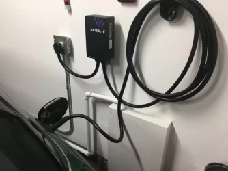

I installed my GRIZZL[emoji298]️E on the wall of my garage near the door so that the 25’ charge cable can be easily used with the MINI parked in the driveway.
(In the summer, I always park outside.)
