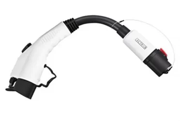

Which Tesla adapter are you using? I've noticed a few on Amazon say they are incompatible with a BMW i3 so I imagine they might not work with an SE either.
Lectron - Tesla to J1772 Adapter, Max 40A & 250V - Compatible with Tesla High Powered Connector, Destination Charger, and Mobile Connector (White) https://smile.amazon.com/dp/B07V7V2...abc_7A9STZYQ1TG85MMJF423?_encoding=UTF8&psc=1
Mine has worked 100% for a year on Jessie, using both a wall-mounted Tesla Gen 2 connector and the plug-in Tesla portable connector. Others on this site have reported similar successes.

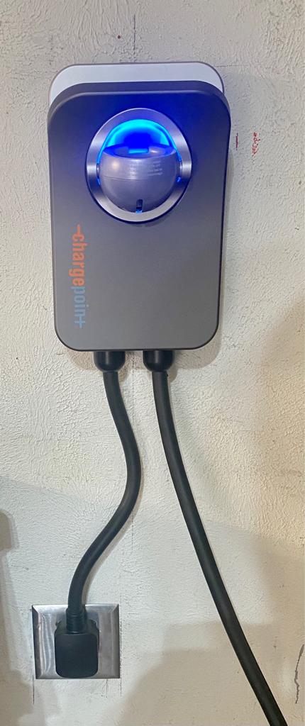

Seems like all of the plug-in EVSE installation guides indicate that there should be a bit of a kink in the wall plug cable & that the charge unit should be installed to one side of the wall plug as per the photo from @fasttr above. Anyone know why this is?
The charge unit is off to one side usually because its centered on the wall support (2x4) and the outlet is attached to the side of the support.
As far as the kink, better a kink than too short a cable :) There may be some rational for thermal expansion or making it easier to unplug or plug into the outlet.
In outdoor areas, you want the outlet cable to form a loop so any water drips away from the outlet. A kink won't do. My outlets are flipped around the other way to accommodate a loop in a short cable.
Anyone know why this is? Anyone know why this is?
The “kink” is to make sure there is no lingering stress on the cable. It’s mounted to the right (or could be left) of the plug because typically the plug is placed either to the left or right of the wall stud and they recommend mounting the charging unit directly to the stud. IMHO, that location of the charger could be done with high capacity drywall inserts but to be honest, almost all plugs will be next to a stud so why not just mount to the stud.
