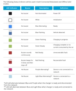

Mine is set to low cost charging, the light sequence is:
blue steady -> plug in car -> flashing blue -> flashing green for a couple of seconds -> solid green -> back to flashing green when in charging window
The flashing blue means that the vehicle is identified but not connected yet

FYI, the Grizzl-e smart charger has these status lights:

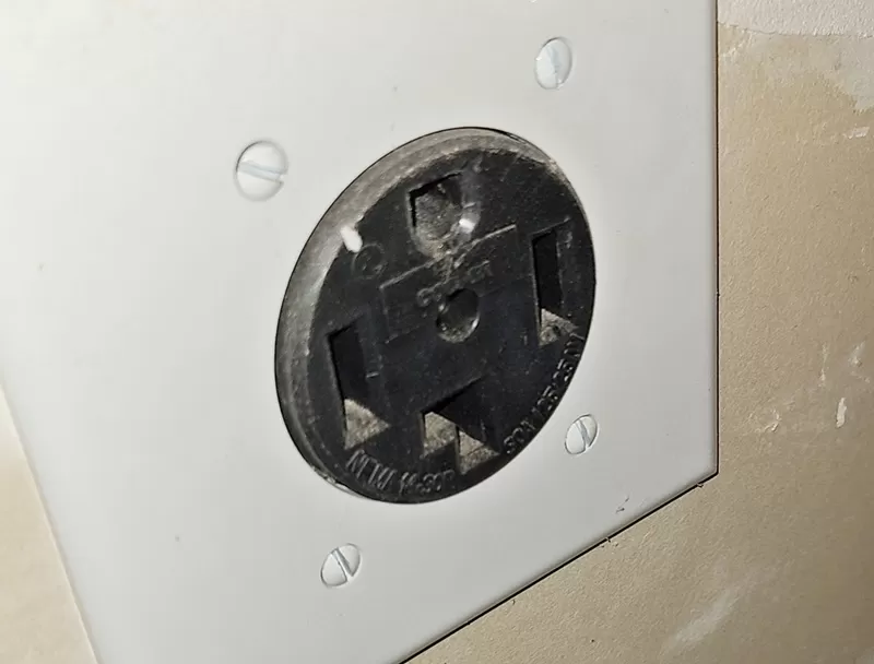

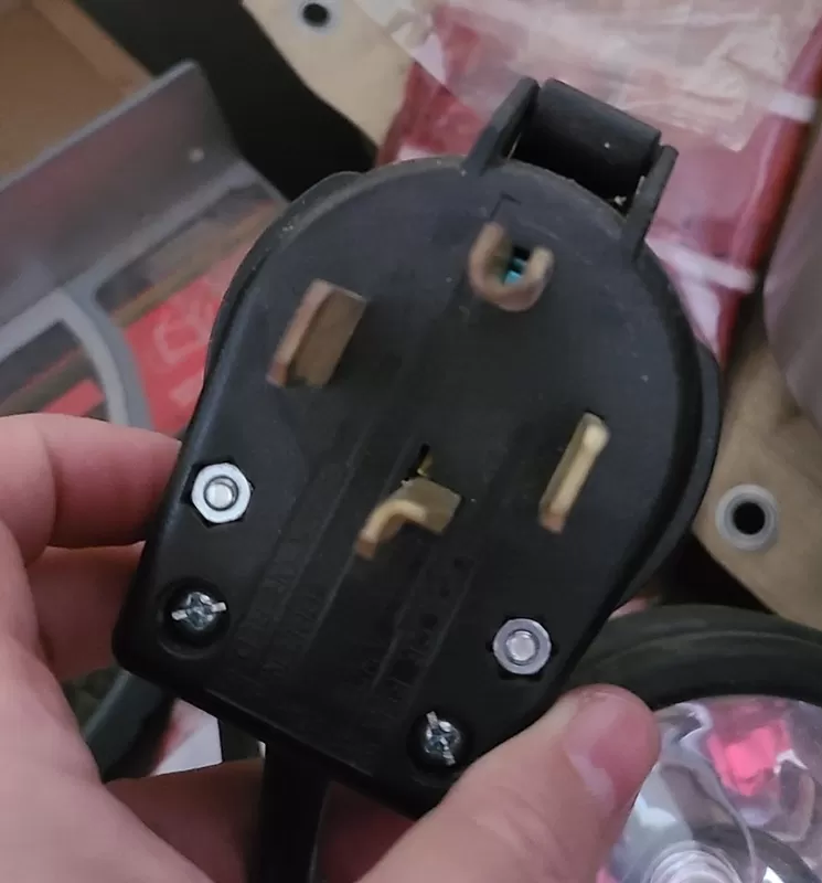

I checked my home 240v plug in the garage and it is a NEMA 14-30R with a 30A breaker in the box. My welder's plug is shown, then the socket itself.
This seems to maybe be an uncommon plug type? I know the current draw is limited by the breaker and that size is limited by the wire size installed. I could pretty easily shut down the outlet and check the wire size, I think. Someone commented that the circuit might be an "intermittent use" circuit since it was used for a welder, but I highly doubt that as the home builder installed it when we ordered it without any stated purpose. That would not have been safe or to code, I would think. Is this really something I need to worry about...if the circuit can really handle 24A steady draw?

Ok so first, the intermittent use:
Continuous use is defined as a load that runs for longer than 3 hours without interruption. Most electrical loads are "intermittent" or non-continuous. Generally, the wire and breaker are selected for non-continuous use so you can only "safely" use 80% of the number on the breaker.
For example: I wanted my 14-50 outlet to support a 42A EVSE so I used wire rated for 50A and installed a 50A breaker.
For the charge point on the 30A breaker:
So the problem with this is that you can't guarantee that the charge point won't accidentally draw 40A or 50A (maybe software glitch, maybe someone charges a different car and doesn't know?). The 30A plug is just its maximum rating, it won't actually limit anything. If you draw over 30A you'll trip the breaker but that's less than ideal. If you draw 29A everything will work but the wire and other components can get hot which is dangerous.
The Grizzl-e is acceptable specifically because it has physical switches to change the amperage limit. Any other EVSE that has a physical way to limit current is acceptable, any software based limits are not acceptable (per code at least).

Sorry...meant that the 14-30 is not common on EVSEs. Is it OK to buy the Chargepoint or Grizzl-e w/ the 14-50 plug and use a heavy-duty, high quality adapter for my 14-30 and call it good?
Rob
Something I mentioned in another post but not here is that my panel is physically maxed out with breakers. I would need to remove something or somethings to ADD a circuit. And I don't plan to stay here more than a few years (17 years already...bought it new in 2004).
Rob
Rob
The easiest answer is to swap the plug and get an EVSE that can limit to 24A. With the small battery in the SE that's more than fast enough for home charging
Rob
Assuming you physically dial down your "future-proof" 50A connector to 24A, and assuming you put a big warning tag on the adapter that lets you plug your connector's male 14-50 into your wall's 14-30R (or other 30A outlet you might choose to install there), I think that would be safe and fine.
