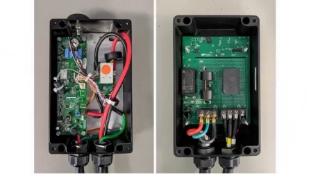

I've posted this before, but the internal design of the Grizzl-E is a very impressive design. It's a major reason I went with it, less to go wrong with such a straightforward design. And the metal box it comes in certainly makes it rugged. Mine came with a NEMA 14-50 plug, but I easily converted it to hardwired, again because of the elegant design.
Here's the insides of a Grizzl-E classic (on right) compared to original JuiceBox (on left):

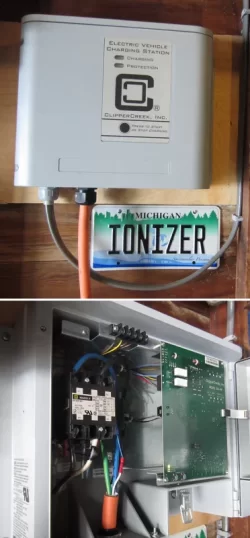

In 2019, when I erroneously believed the US MINI Cooper SE would be able to charge at 11 kW, I spent about $400 for a used ClipperCreek CS60. It was designed way back in 2008, but the company stills sells them for $1,995. Except for the humongous mechanical relay (which makes a very satisfying "THUNK!"), it looks even simpler than the Grizzle-e. ClipperCreek wasn't worried about exterior dimensions--this enclosure is nearly empty.

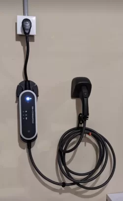

Whenever my MINI actually gets finished and delivered (not holding my breath - I would have passed out by now). I will simply use the Porsche Mobile Charger Plus EVSE that came with my Taycan. I realize this is a very niche choice. Lol.
