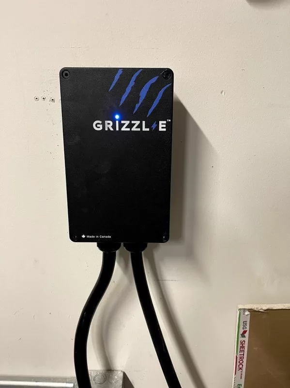

I purchased a Grizzle E charger and had it installed today. When I connect it to the car I only get the flashing blue lights and it never starts charging. Any ideas?
I think earlier in the thread someone mentioned a firmware update. Is your SE fully charged at the moment? Usually that means the vehicle is detected but is not asking for power. If its alternating blue and light blue it means its ready, hard to tell them apart sometime.
I'm at 53% I also tried flipping the dip switches to 32amps
I purchased a Grizzle E charger and had it installed today. When I connect it to the car I only get the flashing blue lights and it never starts charging. Any ideas? View attachment 12751
This is exactly what I had happen (but with the Smart version). I did every possible step to try and fix it. Ultimately, they did a server side update (I think) which made it work. If you want the tech guy's email, DM me (or this website's version of that).
At least on the "dumb" Grizzl-e, there is no light blue:
When my car is plugged and not requesting power (either because it's charged or because of the set schedule) the light is solid green
