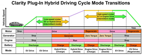

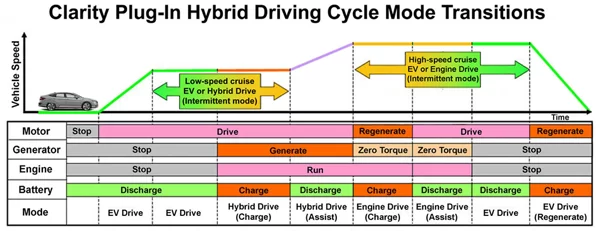

So when the clutch is engaged the engine RPMs should correspond with acceleration? I believe the clutch can only engage around 50 mph?
I believe 45 mph is the minimum speed for the clutch to engage because the gearing for the single-speed transmission is like a 6th gear in a multi-speed transmission. After the clutch engages, I've been able to keep it engaged with my speed as low as 41 mph, but I haven't tried to see how fast I can go in Engine Drive mode.
Note that in the diagram, the speed of the Clarity doesn't change while in Engine Drive mode, indicating it's expected to be used in a speed-holding action rather than accelerating. That sort of makes Honda's claim of 212 hp bogus because when you're accelerating full-out, you have only the 181 hp from the traction motor being fed from both the battery and ICE-driven starter motor/generator.
I have seen the clutch engaged on relatively flat interstates at 65-68 mph. It seems to be perfectly happy to stay engaged as long as you don't ask anything of it. It even stays engaged on slight upward inclines as long as you have plenty of momentum and don't have demands. I think your theory of "speed holding" is correct--but maybe we should call it "power holding". If you ask it for more power, either for more acceleration or hill climbing, the clutch will disengage.
