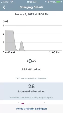

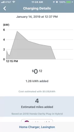

When topping off a charge for a long trip, I started PCing when the taper was at a very low point (first small peak, then large PC peak), then the power spikes for the ~30 min of PCing. I left with full bars and 100% SOC on HL. Range was normal.
I have also PCed after charging is over and likewise left with a full SOC and normal range.
So it’s apparent that preconditioning uses well over a kWh with temps in the 30s F, and if it’s not coming from the EVSE, you battery’s SOC (and range) are going to take a big hit. I don’t know why yours is acting the way you describe.
Notes:
The time scales of the two graphs are very different. The first is just 30 min while the second is 7 hours.
In both, the preconditioning used about 1.3 kWh. This was with temps in the 30s F. I expect bigger draws as the winter gets colder.
