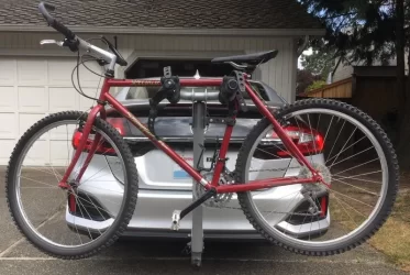

If you had the hitch installed to mount a bike rack, please include a photo of the rack carrying a bike from the view of a following driver. Curious about the visibility of the Clarity's brake lights and turn signals when carrying a bike. Thanks!

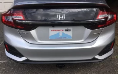

Sure. BTW, they offer both a 2-inch and a 1.25 inch receiver. I opted for the small one, to make it less conspicuous. Our Thule Helium can fit either. This is primarily to hold a tandem bike, but sometimes we carry singles, too. With the tandem, the wheels go in the trunk, because the frame is so long. I'll shoot pix of both bikes.

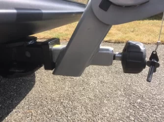

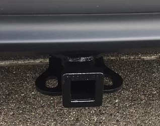

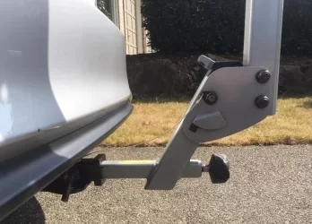

Some photos. The last one is with the bike rack pushed forward as far as possible, but without the safety pin in place. The one change I would make, and will probably make, is to drill a hole in either the receiver or the bike rack to allow the safety pin to be inserted with the rack pushed forward completely. This would minimize the length of the vehicle/bike combination, and also reduce the chance of dragging the plastic tightening knob on the ground, which has happened in the past.
I believe this is a good design, with the receiver exposure minimized vertically and horizontally--that is to say, it doesn't needlessly stick out aft of the bumper, is close to the bottom of the vehicle, and as far away as possible from the ground. It is also powder-coated, so should be rust-free for a while. I was told it can support up to 200 pounds of dead weight. That would be a lot of bikes!

Looks like a thoroughly professional job with both the manufacturing and the installation. I see no signs of cutting or drilling. Is that right; were you able to install it without having to drill or cut anything on the car?
They installed it for me. Yes, they removed some plastic where the hitch protrudes, just forward of the bumper.

So this isn't a DIY install, then. But it is a very nice installation. I remember seeing photos of another custom trailer hitch installation posted to this forum where there were some obvious cuts, and one of them went further than necessary. Looked rather amateurish. I don't remember if that was on a Clarity PHEV or not. Was that a U-Haul custom job?
This installation -- is that by TorkLift? -- is much better. :)
Yes, they designed it and installed it. Their engineer did 3D modeling to get the fit they wanted. One of the changes he said they made, late in the process, was to make the receiver flush with, or even slightly recessed from, the aft edge of the bumper.

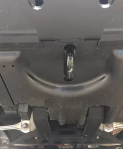

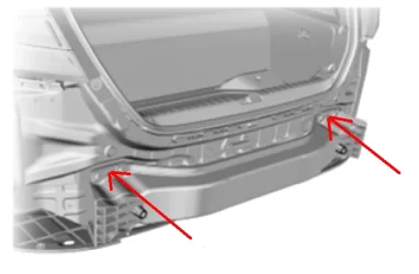

According to the Honda documentation, the rear bumper beam is Glass Fiber Reinforced Plastic ("World's first") and this beam mounts to 270MPa steel. Assuming Torklift is doing what they've done with other models, they are sandwiching the mount plate of the hitch in between the frame and the bumper beam. I'd want to know if the bolts that installed the beam are long enough to allow for the additional thickness present in the joint and fully engaged the threaded holes in the frame or if they had to be replaced and if they were replaced, were bolts of an equivalent strength used. The Torklift webpage for the hitch no longer shows the hitch assembly by itself, but the picture I saw there previously had only one bolt hole at the top of each mount plate, whereas the Honda image of the bumper beam attachment shows two holes at the top.

@Steven B, I was able to get the installation instructions from Torklift - it does attach behind the bumper beam. And, as you indicated, I believe that area is all steel so there should be no issues. Either way, when I install it I will double check with a magnet to be sure.
They do include new bolts, washers, and lock washers with the kit and they are Class 10.9 M12-1.25 x 50mm (even calls it out on the instructions). I'm not sure what the original bolts were, but it certainly seems someone put a lot of thought into it over at TorkLift. They even give the torque spec.
