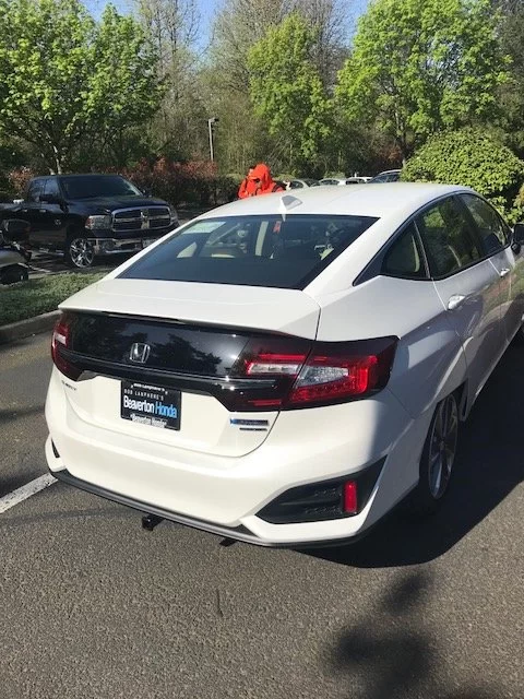

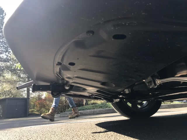

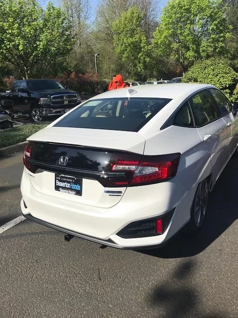

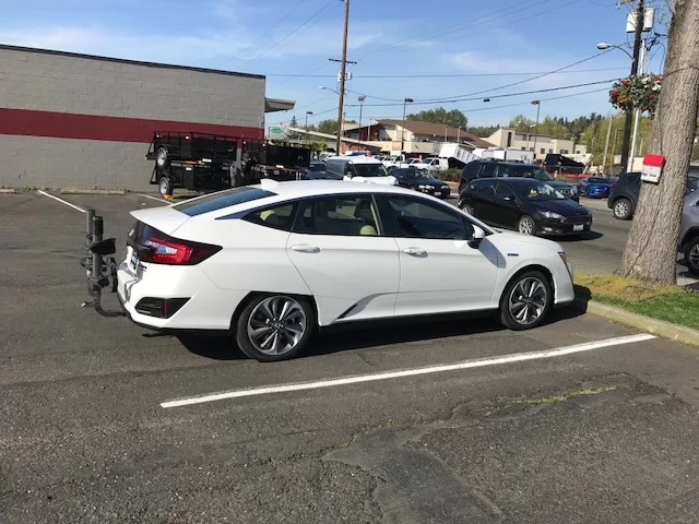

Hey everyone, I was able to take my 2018 Clarity to Torklift in Kent, WA and they custom made and installed one for me. So it certainly is possible and it seems to work pretty well so far. I let them know about this forum and that others were interested, but unfortunately they still aren't planning a commercial one at this time... custom only.

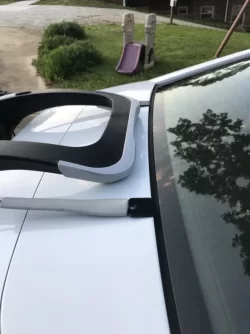

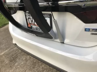

I have the Thule Raceway Pro on mine and it is solid! No scratches. It rest on the little lip below the tag and the small aluminum section of the trunk. I am going to install some of that invisible film on the trunk just in case. I do want a permanent hitch at some point.

Congratulations samzilla3, I think you are the first to post a permanent type bicycle hitch for our Claritys.
There are several people on this forum looking for a hitch for bicycles and even light towing.

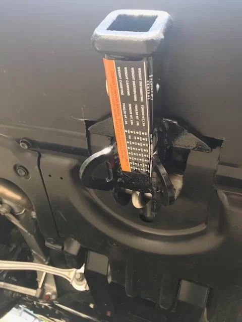

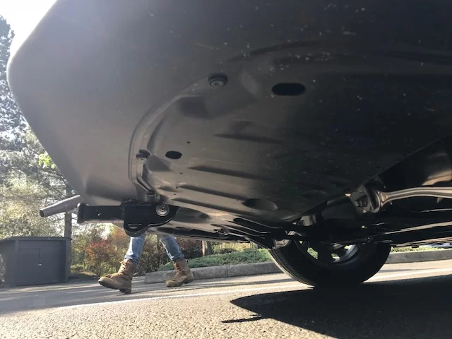

Would you post some closer pix of the hitch and how it’s mounted to Car underneath. Also would you give us some more details. As in is it a receiver type where bicycle rack removes when you don’t need it and the size of the receiver. What load limit does it have and how much did it cost.
I would like to use the pix to see if my local shop can make one for not too much. Thanks

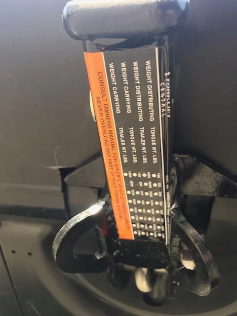

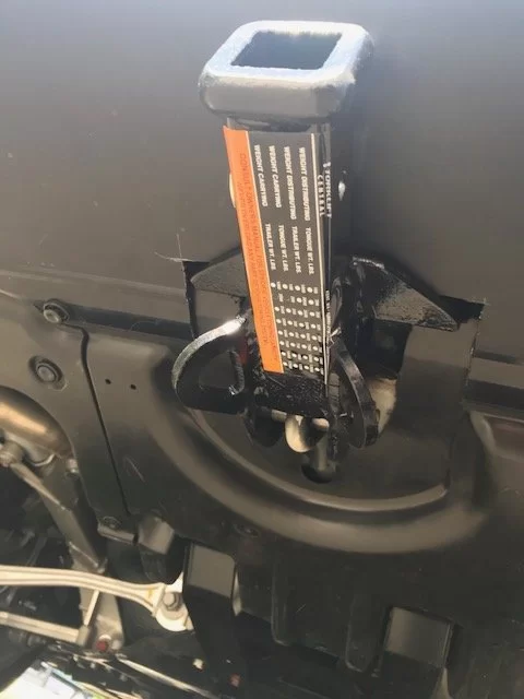

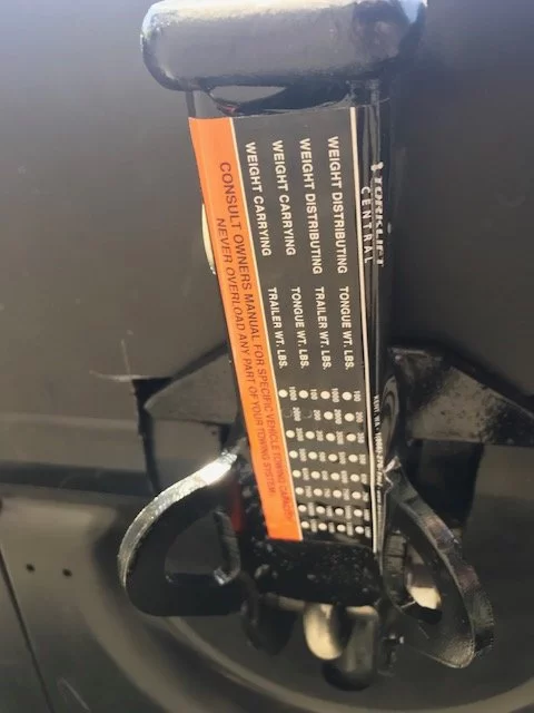

Sure thing, here is the rundown:
* Cost was around $900, and they had my car for two days. The latter half of day one was design and the second day was fabrication and installation. Spendy, but bike racks are fundamental to my daily commute (I will park the car part way through and cycle the rest of the way to get past freeway jams).
* It is a 1.5" receiver, and looking at the sticker (see photo) it looks like the rating is for 2000lb trailer and 200lb tongue.
* When I asked them how they were going to do it, I think they said it would be attached to the impact bar behind the bumper. I am not an expert in this area, but I theorize it was fabricated/installed like the one in this video (with the addition to bolting on to the original tow hook): https://www.etrailer.com/tv-install-trailer-hitch-2017-toyota-prius-c11426.aspx
* Since I was already paying extra for custom, I asked if they could go full aluminum to save weight. They said no because the welds wouldn't be strong enough.
Thanks for sharing and for getting down on the ground for us. As an older driver, I especially appreciate that last part!
That’s a very nice and neat install. Looks like your shop did a great job.

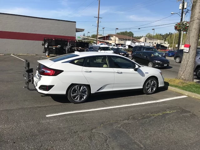

Great stuff, thanks for sharing! So, have you noticed what sort of impact the rack has had on electric or gas mileage?
Thanks @KentuckyKen ! I was actually pretty concerned initially and whether there were mount points... so I'm happy to say that there isn't any fundamental problems with the car and an add-on hitch receiver other than the PHEV version of the Clarity is pretty new to the market and no one has got around to making a commercial one yet.
Also, a note on fuel economy/MPG - I had to drive about 2.5 hours from Portland to Seattle and back to have the work done. On the way back I installed the rack to the trailer seen on the first photo I posted. I didn't notice any efficiency/MPG differences on the way there vs the way back. As expected, it took a little under 1/2 of battery and gas each way (170 miles)... driving in HV mode around 70MPH most of the way. I filled the tank in Seattle. Now I'm not saying there wasn't any difference in fuel economy, but it would probably take a pretty controlled experiment (accounting for temperature, driving technique, average speed, etc) to actually see one. I bet most drivers wouldn't notice. In the past I have had a roof rack with a fairing and this did make a difference, but I think it will be negligible with rear trailer hitches.

So i finally got time to go check out the underside of the car - at this point I have not removed any plastic underpanels as part of my investigation but from looking very closely at everything else, there are NOT any threaded holes anywhere under the rear of the car that appear to be meant for mounting a hitch (some small ones in awkward positions that were in the M6ish size-range, but that's not nearly enough for even a light-duty hitch). While I think it's great samzilla3 was able to get a custom hitch that works for him, I personally don't feel comfortable attaching a hitch to the metal inner bumper and I'd really prefer to not have to cut any of the plastic covers under the car to make it work.
That being said, a couple years ago I helped a friend put a 3rd party hitch on his Honda HRV and it used a kind-of 'toggle' bolt to attach to the unibody 'frame' of the car. There are a set of holes that appear similar on our cars, and appear to be in the correct place for bolting up a hitch, so maybe someone will make something that will work in that way?

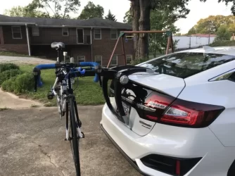

I am using the Thule Raceway Pro 3. Sure, it’s not as good as a hitch mount. However, as I wait for that solution to arrive its works fine. I have used it now 10 times on and off. Once driving over 350 miles with not a single scratch or rub mark. Other than a 15% decrease in fuel economy, it is the most trunk mount bike rack I have owned. I routinely leave my bike on it and open the trunk. When installed it becomes part of the car with no movement at all! Hope that help my fellow cyclist while we wait out a hitch solution.
Can you post a photo when you get that set up?
