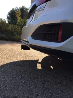

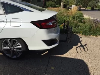

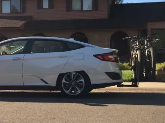

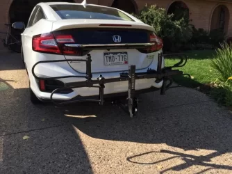

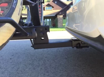

I have had my 2" Torklift receiver hitch on for about 2 months. Very solid. I have a heavy ebike (probably a second in the near future) and bought a Hollywood rack designed for the extra weight (SPORT RIDER SE FOR FAT TIRE ELECTRIC BIKES). Very solid combination. No sway and handles well. I haven't had this on any bad roads (bumpy), but don't doubt it will all be solid, even with a second ebike. Anyway, it took me a few hours to install. The Torklift rack came with the wrong bolts (wrong thread). They responded quickly and overnighted the correct ones to complete the install. Here are a few pictures.

Looks good. Did you have to cut any plastic?

Thanks for the photos!
You didn't show any pics of the underside of the hitch install, but at least from what we can see, it looks like a very "clean" and professional-grade installation.
Great to read, from your report, that it's very solid and that you're happy with the hitch!

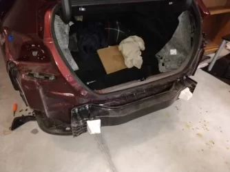

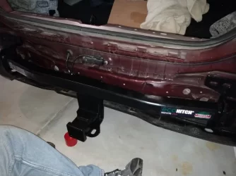

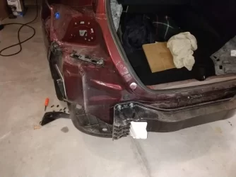

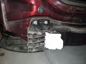

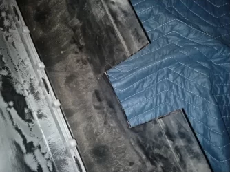

I got an eco-hitch from TorkLift (disclaimer, it was comp'd) and installed it myself (with the help of a couple buddies.) Let me know what questions you have and I'll do my best to answer.
Things I can think of off the top of my head.
1) Cutting of the BUMPER is not necessary, but cutting of the UNDER COVER is 100% necessary. If you are careful as you do it, it is not noticeable at all when you are done.
2) The hitch itself seems very solid. I had my empty bike rack on it but, unfortunately, the white stuff has started falling so I haven't actually put my bike on the rack yet.
3) They do include new high-strength (class 10.9) bolts for holding the metal bumper on.
4) I successfully did the install without breaking any plastic clips.
Let me know what questions you have!

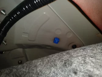

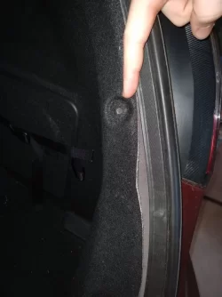

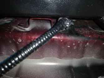

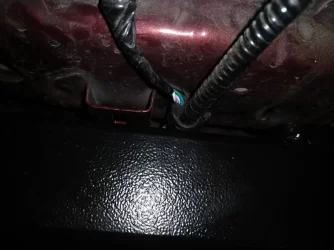

1) I suspect the wiring in the center is for crash sensors in the bumper beam. Since there are two harnesses, are both for crash sensors or is one for trailer lights? Describe any disassembly from the beam that those needed.
2) No wiring of trailer lights performed? Any instructions from Torq-lift on wiring for lights for our specific model?
There are no rear bumper crash sensors on this car. Admittedly speculation but it looks to me like wire is simply for trunk ajar sensors or similar. I assume he's showing just minor relocating and moving them out of the way. I doubt that anyone is wiring lights as nobody should be towing trailers with these hitches. They are being installed as supports for cargo carriers and bike racks. No lights required.
I believe that wire was actually to the beeper that makes a noise when you lock the car, etc. For some reason that I don't understand they located it behind the back bumper. The wire you see moved was just because the clip that holds it in place as it stuck out too far to get the hitch mounted properly.
In terms of wiring, they did not provide any instruction. My guess is the same as craze1 that they don't actually expect you to tow with this hitch since the car is not at all braided for it. If you wanted to wire in a light to put on the back of your bike rack or something, you could probably splice into the tail light wires that were accessible in the trunk as part of the process. Personally, I don't like splicing into wiring, even though my degree is in electrical engineering. I feel like it is one of those things that is too hard to undo later.
