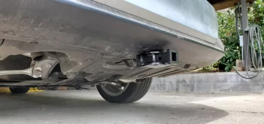

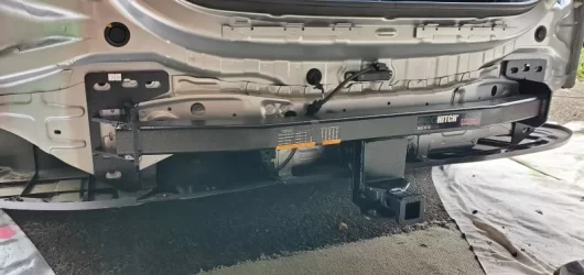

Just installed, went smooth as silk. Not difficult at all, took less than 2 1/2 hours going very slowly and carefully. The instructions were very clear and the fit of the Clarity body pieces was very good. All in all a very elegant mount, highly recommended.
Great install and look. But I gotta ask, what’s holding the hitch up while you took the first picture? I don’t see any bolts.
I see little brackets in the center of the top three oval cutouts.
Is this the 2" or 1 1/4"? I can't estimate from the pics.
1 1/4", The instructions are very good but it would be nice if they specified the tools needed, which are:
1/2" drive breaker bar w/ 6" extension, 14MM and 19mm sockets
1/4" drive w/ 2" extension, 8mm socket
5mm hex wrench
Phillips screw driver and trim clip tool
It's nicer to be able to get the job going without multiple trips for that tool you forgot. Also, the crash bar is only made from some sort of composite, so now with the hitch mounted as well it seems much better protected against rear end collisions.
