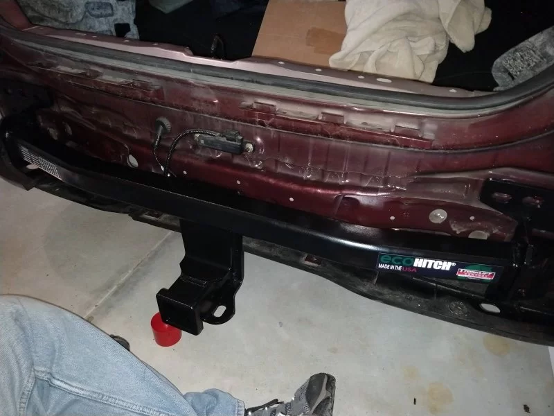

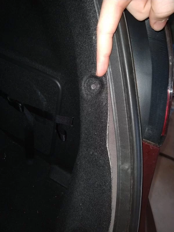

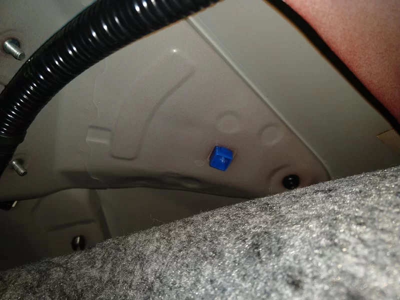

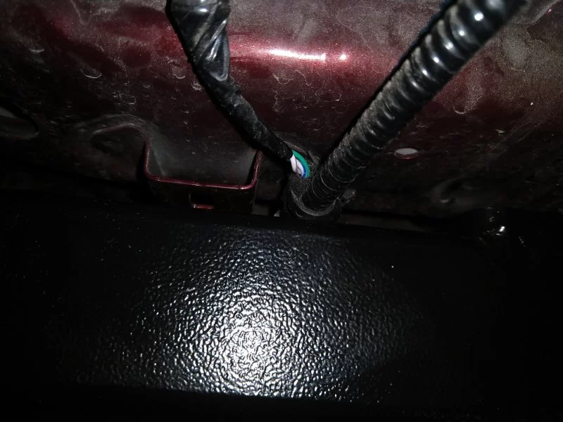

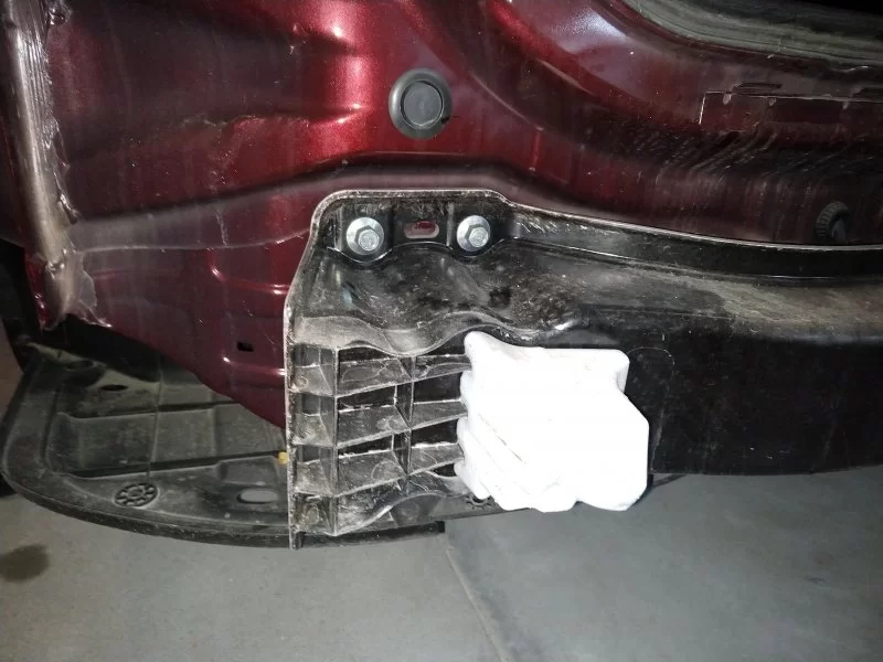

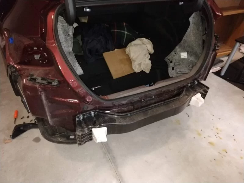

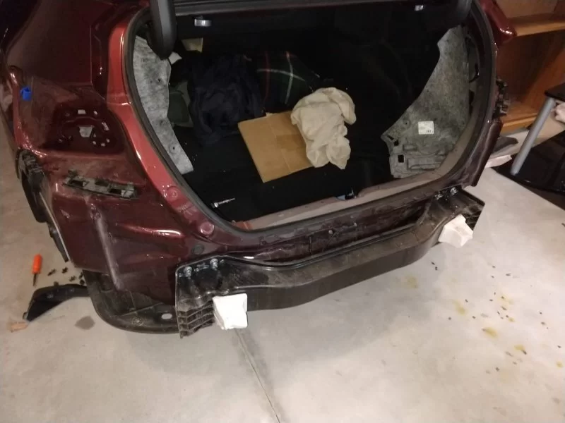

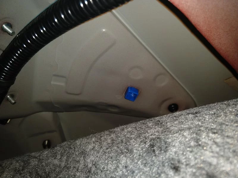

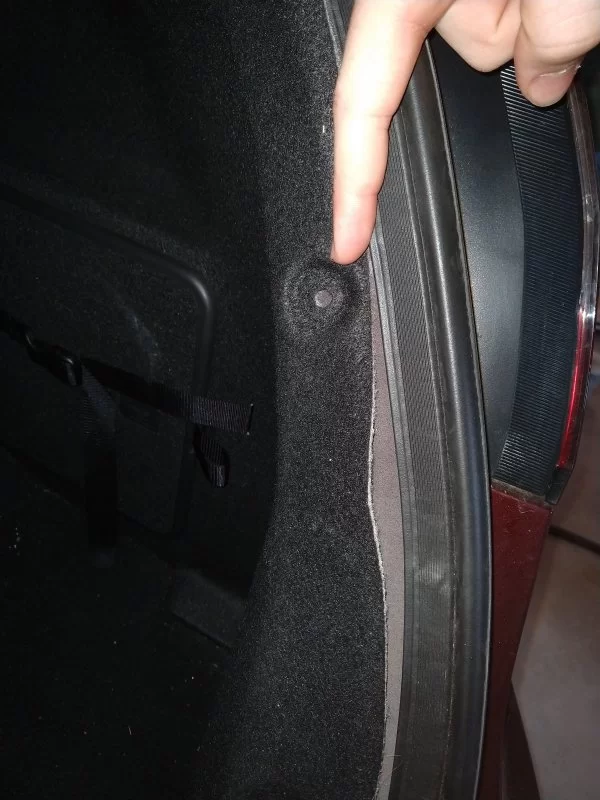

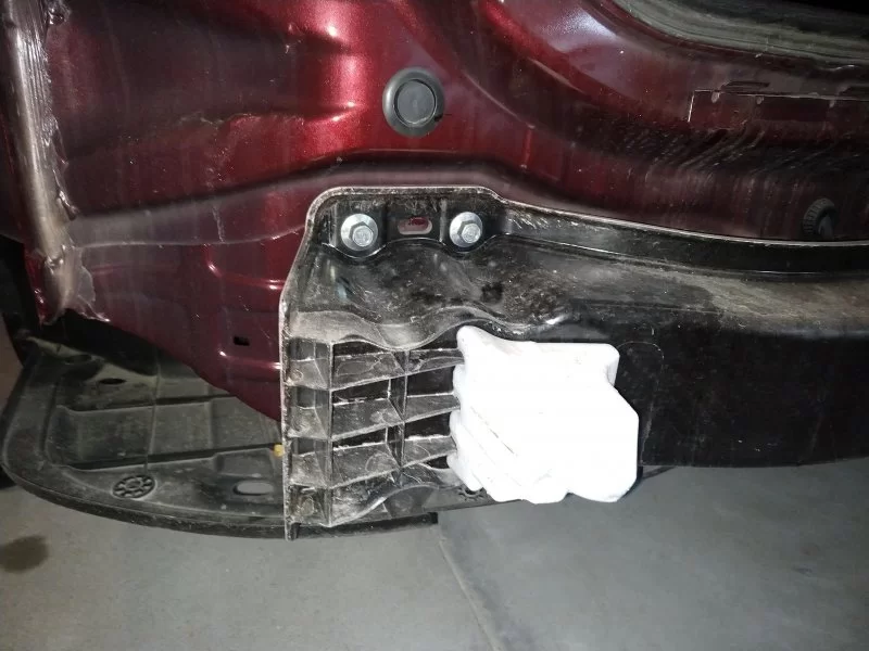

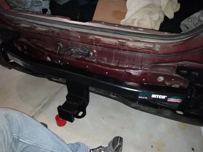

Thanks all. Just installed my torklift exohitxh 1.25”. Directions were very clear, no issues.
I was glad I had the following items on hand:
-Trim plug removal tool set
-Some spare trim plugs (since I broke one anyway—eg Amazon B07918F45L)
-Torque wrench with range that covered the specified 85 ft-lbs

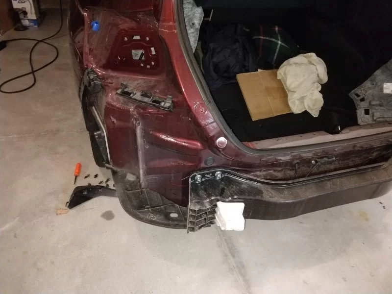

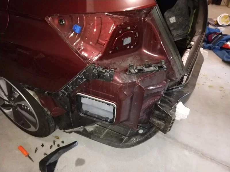

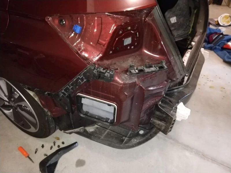

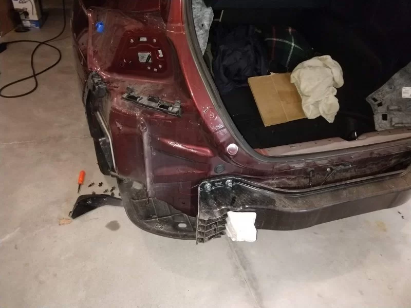

I'm going to install an EcoHitch, was wondering if you plan to install mud flaps at some point if it would be more convenient to just do them at the same time?
Probably helps a little. We removed the rear wheels to have more room to install the rear mud flaps (probably not absolutely necessary, but helpful to have more room). Having the car off the ground to do the trailer hitch would be a good time to remove the wheels as well.
I just put in the ecohitch. You would save a tiny amount of labor by doing the mudflaps at the same time (removing two easy screws, and one pop rivets, on each side of the front end of the bumper fascia). You don’t have to raise the car up to do the hitch (though you can)so that’s not an issue either.
So I don’t think it matters If you do them at the same time or the hitch first.But what I would not do, however, is put the mudflaps on and then do the hitch later. You would have to remove the mudflaps again to do it I think, and that is the most elaborate part.
