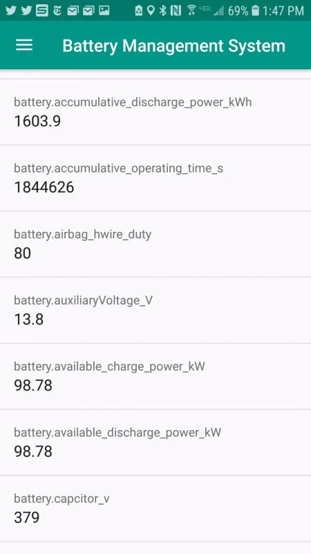

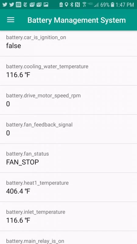

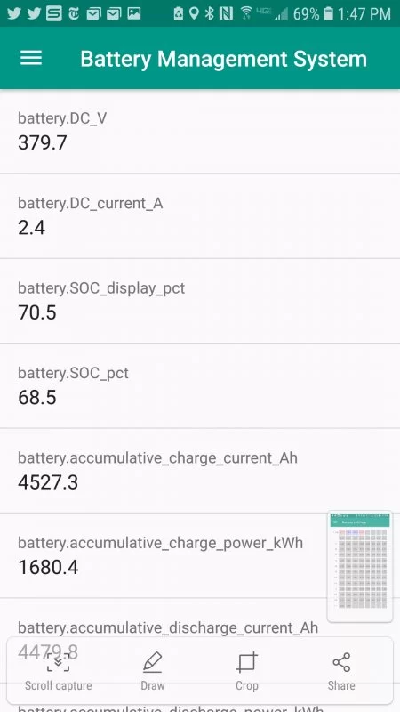

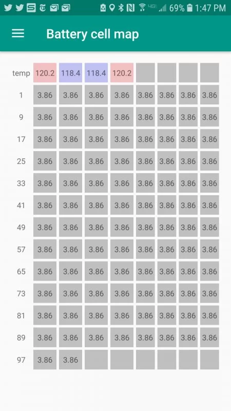

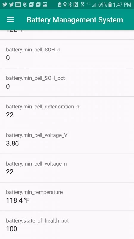

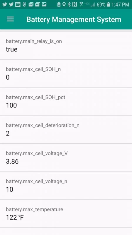

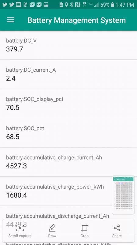

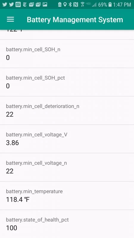

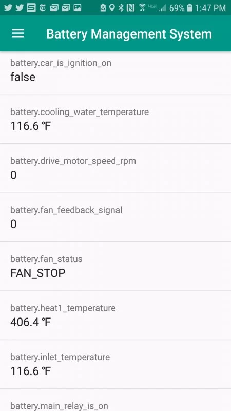

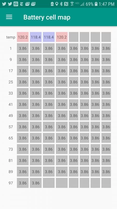

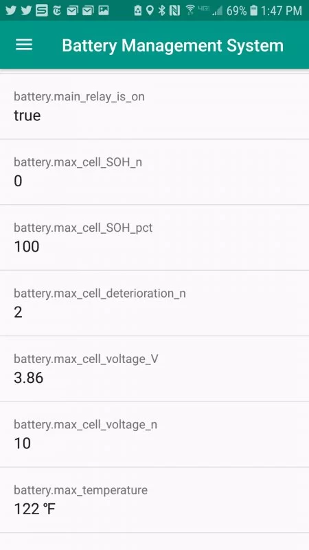

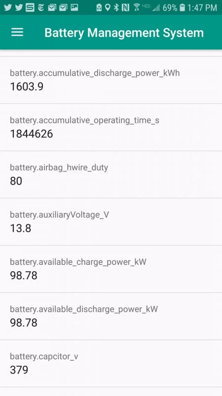

I was reading that thread related to hot batteries during DCFC (50C), which lead me to the epic thread on SpeakEV related to failure of the battery cooling system, and that got me thinking. I went back and looked at the SoulEVSpy data that I had on my phone, to see if anything jumped out at me. And boy did I find something. The GPS data from this was from 2020/06/03 18:14:53.
I would note that this all goes back to Jun 3rd while (or after) I was doing a DCFC. It was hot out that day - in the 90s. Note that on that day, there was no battery degradation that could be seen in the cell voltages. All are identical.

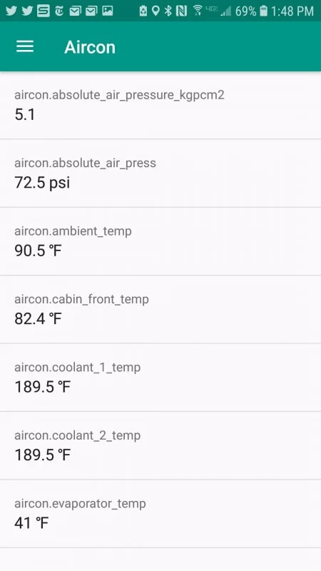

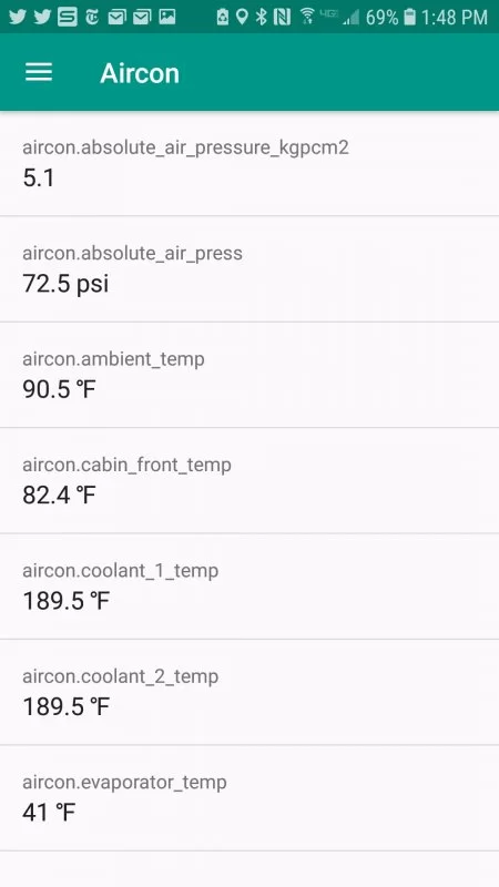

The design of the system suggests that at these temperatures, the AC compressor should be running, and delivering chilled coolant to the battery. Fortunately SoulEVSpy helps here too.
Evaporator temp was 41F - that sounds normal enough for a hot day like this with the compressor running. Cabin temp of 82F doesn't sound that bad. Now let's look at the BMS (5 pages of data):
So battery *inlet* temperature was 116F. Based on the other thead, it should be something closer to 15C or 60F. As noted the AC compressor was running, which seems correct. So it sounds like I have/had the same problem as the person in the UK where their battery wasn't cooling properly.
There are a couple of other pages that I have screengrabs for that I am not posting (just to keep from overwhelming people with irrelevant data (tire data, OBC, GPS, for example).
Unfortunately I don't have the car right now, and by the time I get it back, the high temperatures of summer will be gone, so I might not be able to test further until sometime next summer. The other thread here suggested that the BMS update corrected the problem where chilled coolant wasn't circulating - until I get a chance to test again, I won't be able to test that myself.
I have a different log from 06/21/20 - that one showed more normal temperatures, and cell 40 only had a voltage difference of 0.02V. Hardly enough to notice, really.
I did a DCFC the day before the BMS update, but I didn't use SoulEVSpy on that day, so I have no data. But it was also hot out that day...
View attachment 9272 View attachment 9273 View attachment 9274 View attachment 9275 View attachment 9276
Thanks for the screen shots...SoulEVSpy certainly provides a lot of useful information. Eventually (when the car is paid off) and I will have a few bucks for toys (like a phone and dongle etc) this will probably be the program I will use.:)
