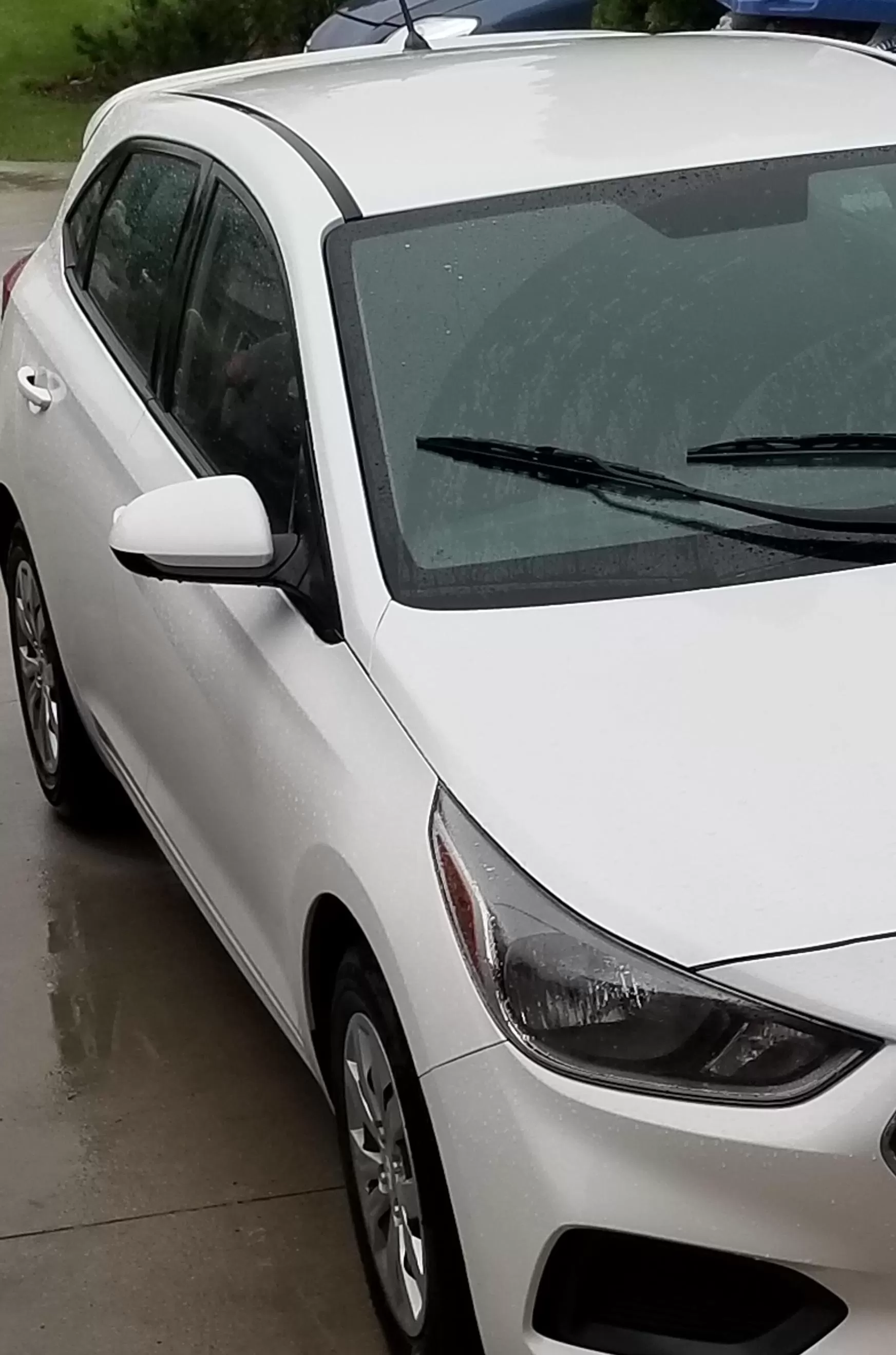

I gotta laugh as I am starting to like the loaner Accent as it starts regularly, gets me to where I need to go and gets a very respectable 5.2 liters/100km fuel consumption. It has he same cheapy interior quality as the Kona. If it had adaptive cruise control and LKA it might be a contender :) Had a look at my paper work today and between dead batteries, motor swap and no start condition this is my 10th unscheduled service visit in 9 months of ownership. I am starting to know everyone in service department a little more intimately than I really should.
