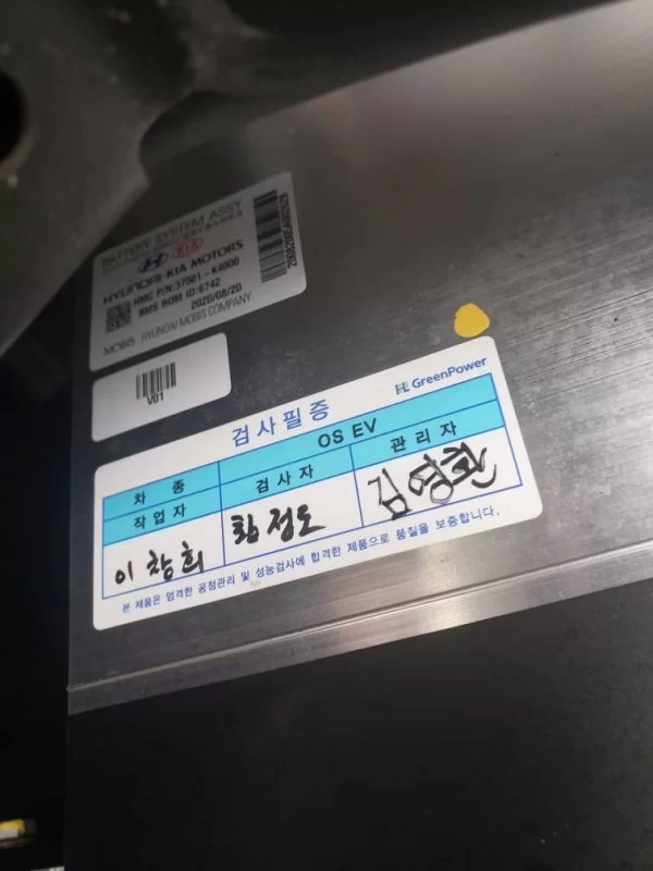

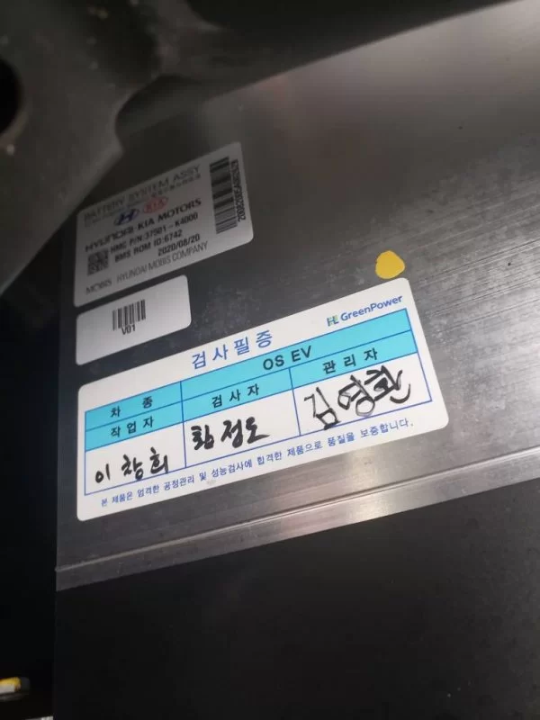

Getting a camera in a spot to take a pix of the sticker isn't easy.
Anyways, battery was made on August 20, 2020. ROM id 6742.
Anyways, battery was made on August 20, 2020. ROM id 6742.View attachment 9829
Thanks for that, great job on the picture. Odd how your build date is 7 days earlier than mine, yet a completely different part# and BMS ROM ID.
( my 2021 model : 37501- K4054, BMS ROM ID 6980)
Glad to see a photo of the HV battery label. Please describe where I should look for this label (my Kona-EV mfd. 26 Oct 2019). Thanks.
You can find it near the rear axle on the drivers side. You might be able to easily spot the lower of the two stickers, but that one doesn't tell you much.
