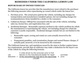

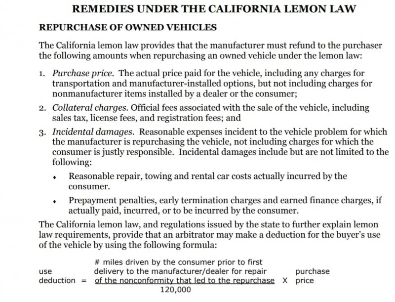

It seems they do? I searched around and found this.

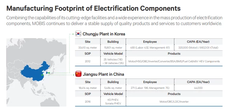

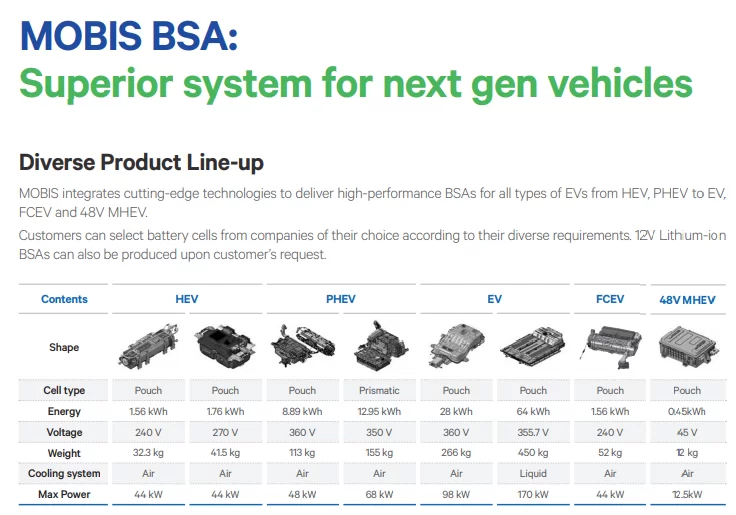

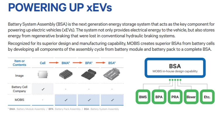

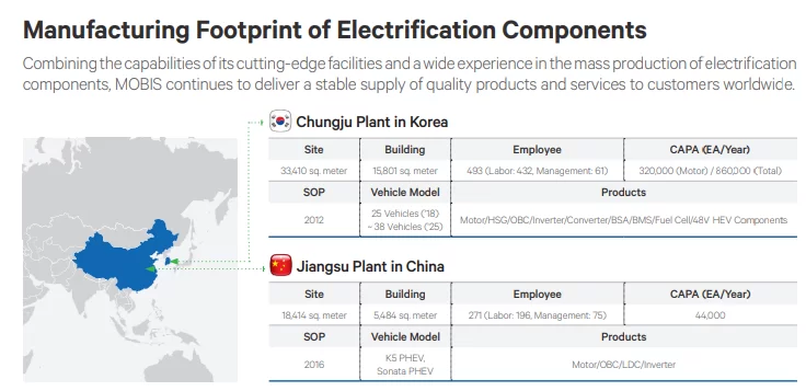

The brochure is sort of a sales brochure of sorts, but it has some information. Basically confirms that Mobis buys the cells (LG Chem?), and then builds the rest of it themselves.
