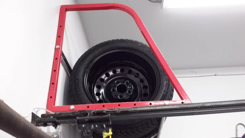

Got my winter tire/wheel set thru 1010tires. Michelin snows on black steel wheels with TPMS, $1630.40 all in, delivered to my house.
All set for winter, maybe supply more info on the tires (model etc and the rims) I trust that include TPMS sensors?

Yes, that price is what was charged to the credit card, includes plain black steel wheels, TPMS, Hunter Road balancing, home delivery, taxes, eco fees:
The tires are Michelin "X-ICE Snow"

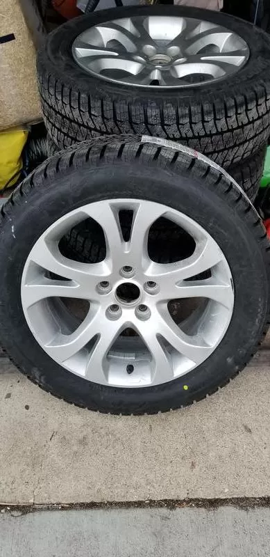

I posted a pic of these before but since we are talking about winter again(uggh) and for the sake posterity these are my Kona's snow shoes, made in Japan Bridgestone Blizzak WS 90 215/55/17 that I picked up last year, they came from quattro tire. They were mounted to a cheap used set of 17 inch Hyundai aluminum wheels I got off of Kijiji. The winter set of wheels and new tires, new TPMS sensors and new center caps came to a total of $1180, shipped, mounted, balanced and taxed. For whatever its worth they saw lots of snow last year and overall handled the Canadian prairie winter exceptionally well. I would absolutely buy these again. I still like the wheels and IMHO the Kona rocks them better than OEM aero wheels. Its one of the few vehicles I own where the winters wheels look better than the summers :) .
