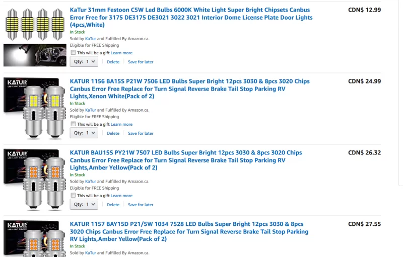

And this is what my Amazon.ca shopping cart is shaping up, for the exterior bulbs EXCEPT the headlamps, plus the 33mm interior bulbs:

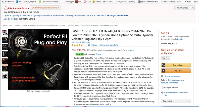

I "think" this is what I'll get for the headlamps from Amazon.com:
Headlamps from Amazon.com have been ordered.

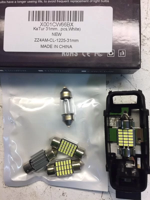

Vince08: I was able to get that cover off the lamp in the cargo bay using a jewelers slotted screwdriver at the correct edge.

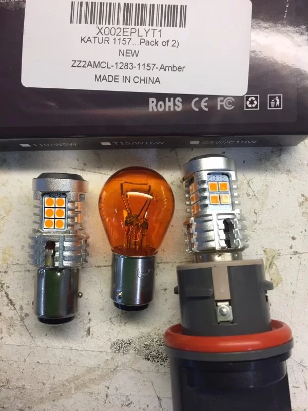

All exterior lamps, except the headlamps (awaiting delivery) have now been converted to LED with no fan fare:
Front turn signals:
Rear signal lamps:
Backup lamps:
...and the rear cargo area.
Front turn signals:
Rear signal lamps:
Backup lamps:

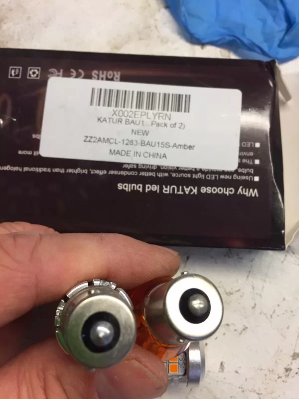

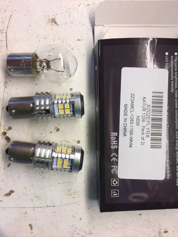

That was quick, even for air freight! The back up lamps (#1156) curious to see how bright they are.
The pictured products were all fulfilled by Amazon, I suspect they were in a warehouse in the Toronto area (I am in eastern Ontario).
My 15 second test of the back up lamps in my darkened garage leads me to believe they will be more than adequate for the task.

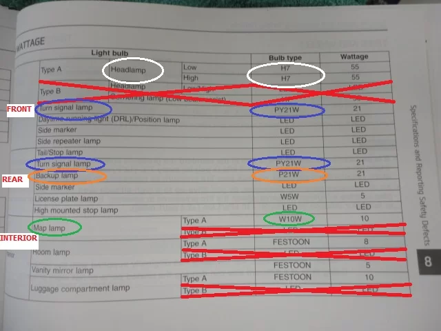

So, in any event, I'm going to want to swap out all the external lamps (with the possible exception of the hi-beams) and the internal lamps (with the exception of the vanity mirror lamps).
This is a shot of the actual bulb chart from the owners manual:
Any firm I contact at this point cannot tell me definitively if their 2020 bulbs will fit in my wife's 2021.
My first ask from the community: could you look at your 2018/2019/2020 bulb chart and confirm what the circled bulbs list at?
After Labor Day weekend, I'll probably remove each bulb, take some pictures and measurements and post them here for comparison/comments.
And I did the rear bulb swap outs with my back on a creeper...once I did my reconnaissance of the rear under chassis trim part I knew what to expect.

They have not arrived yet, the package is supposed to arrive at or after 15 Sep 2020.
I bought via the US Amazon site:
I'll post my headlamp results (and headlamp re-aiming technique, if required) once they are installed and it is night-time...;)
