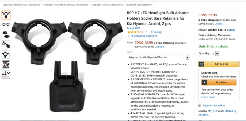

As for the adapter, I'm at the office right now so restricted on printscreen but you can search below and you'll find it
So far it fit perfectly the Aukee LED bulbs, the advertising says its made for the RCP bulbs but that's not true at all. It also looks identical to the ones your LED kit comes with
RCP H7 LED Headlight Bulb Adapter Holders Socket Base Retainers for Kia Hyundai Accord, 2 pcs
Cheers.
Okay, seen.
Here is a screenshot of those adapters:

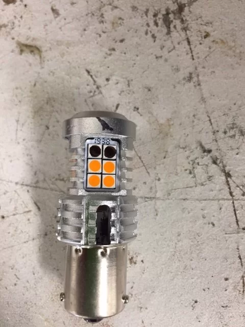

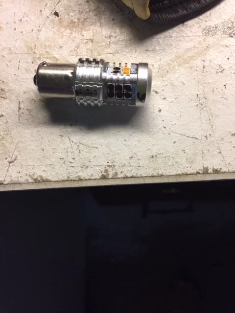

Dealt with the very bright turn signal bulbs today (I'm leaving the backup lamp LEDs as is, the more light the better AFAIK).
Bottom line: I used a black Sharpie pen to cover the individual LEDs.
All four bulbs eventually had the following done to them:
This first shot is during the trial and error phase:
Ultimately, on each of the four bulbs, the following was done:
The above shot is typical for all four bulbs.
The sides that have six LEDs, all six are covered.
The sides that have four LEDs, the bottom two are covered.
To review: out of the 20 LEDs on each bulb, 16 are covered and only four are left original.

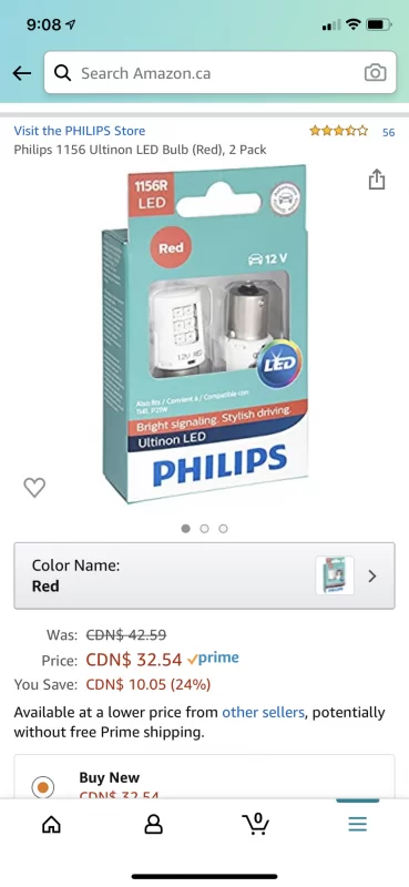

This is the model I’m getting for the Philips
I got these in the past and they were perfectly fine lights.....let’s not forget Philips as a brand can’t afford having LEDs that blind folks. So they definitely turn it down a notch.
